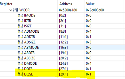

Hello @LCE ,
Yes you are right RWDS pin is the same as the DQS signal.
I used the OSPI_HyperRAM_MemoryMapped example to check HAL and Cube, and I found that the DQS is set without any issue.
