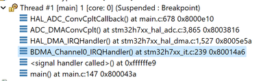

Which function is actually calling HAL_ADC_ConvCpltCallback() ?
Iris-DMAuthor
August 4, 2023

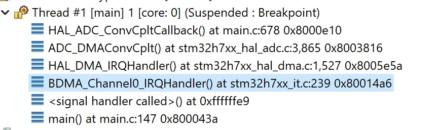

I'm trying to avoid using the regular DMA (mainly out of stubbornness) but I'll give it a go if nothing else works. HAL_ADC_ConvCpltCallback() is being called by the BDMA IRQ - see call stack below.
It's called by the BDMA IRQ handler even in the instances where the destination buffer isn't overwritten. So either the DMA transfer is taking place and the values just aren't changing, or the DMA IRQ is getting called before the transfer takes place - perhaps the interrupt flag isn't cleared after the first set of transfers?
