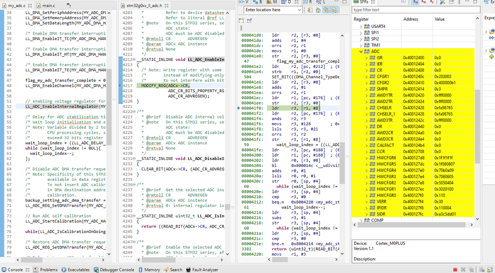

I have a code for stm32g070 which configure the adc as continuous conversion mode, sequencer set to fully configurable, scan conversion mode, dma continuous request, end of sequence conversion, oversampling mode right shift to 5 and ratio 32x.
Also I configure the dma as circular mode with peripheral to memory direction, using an array buffer uint16_t with 1200 halfword size, and enabling half transfer, complete transfer, and error transfer interrupt.
When the conversion start, the half transfer rise, but the buffer is completely full, and after complete transfer end, the buffer is overwritten.
Here the code:

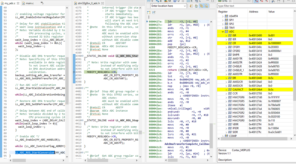

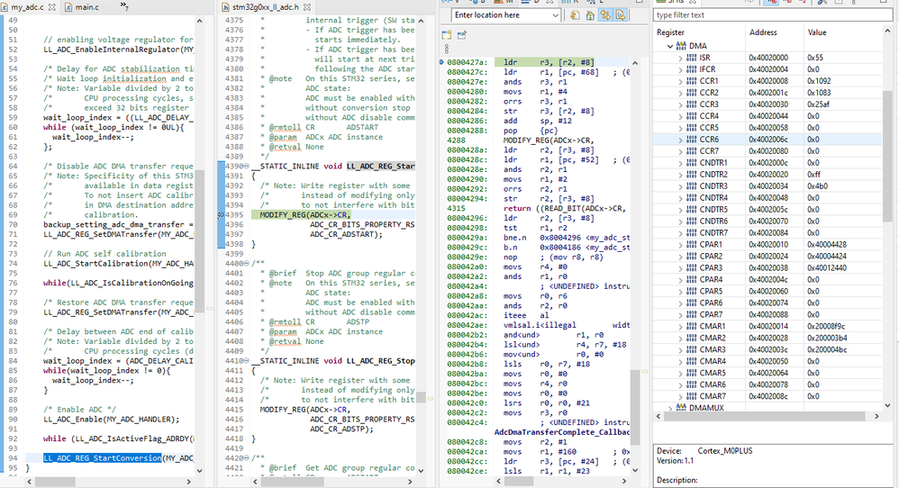

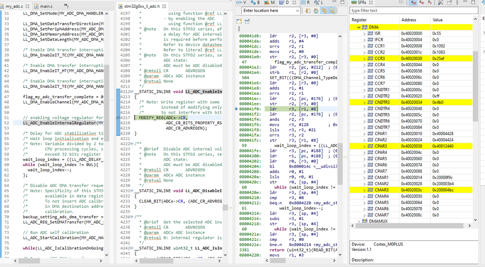

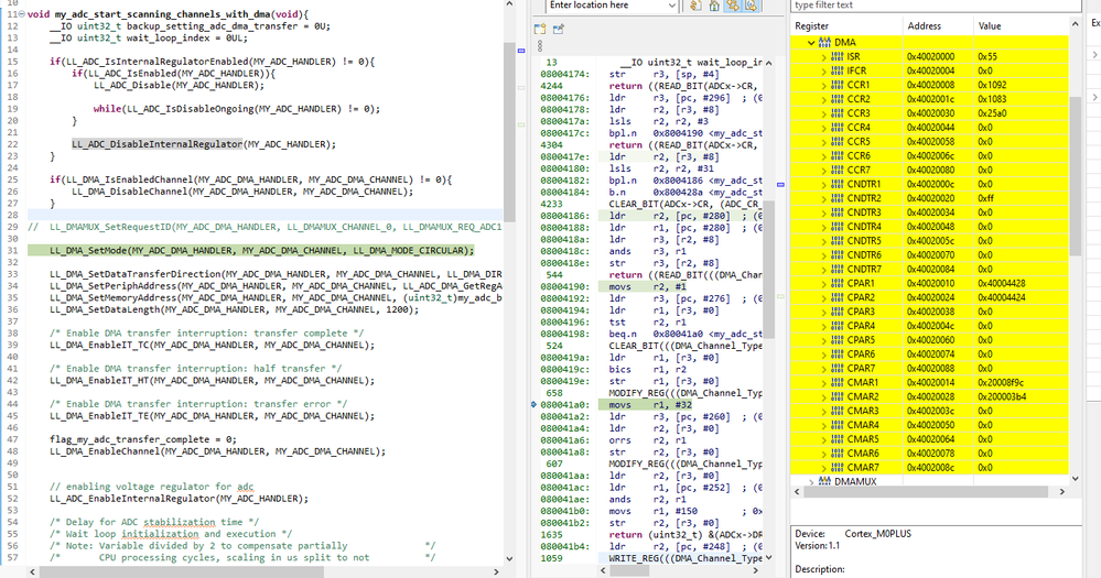

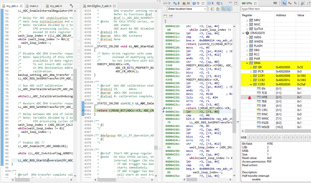

This is a capture before to configure DMA with buffer.
0693W00000GZ7PlQAL.pngAnd this is before to enabling ADC v regulator.
This is before to calibrate and config ADC
and this is right before to start adc conversion:

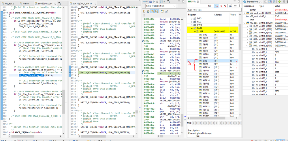

> However I am still having the issue with buffer filled completely when half transfer dma flag arise.
Looks like you're using stream 3. But HTIF3 isn't set in any of your screenshots, nor is execution within an interrupt.
JCuna.1
Senior
In these lines I configure dma channel 3 transfer interrupts
/* Enable DMA transfer interruption: transfer complete */
LL_DMA_EnableIT_TC(MY_ADC_DMA_HANDLER, MY_ADC_DMA_CHANNEL);
/* Enable DMA transfer interruption: half transfer */
LL_DMA_EnableIT_HT(MY_ADC_DMA_HANDLER, MY_ADC_DMA_CHANNEL);
/* Enable DMA transfer interruption: transfer error */
LL_DMA_EnableIT_TE(MY_ADC_DMA_HANDLER, MY_ADC_DMA_CHANNEL);
And checking the DMA register it is effectively activated:
HTIF3 is not set because the capture is just related to the register before to start a conversion.
JCuna.1
Senior
When the first half transfer interrupt arise I can see that a transfer complete interrupt flag also arise.
The sampling time with dma is corroborated here, however, debugging process show me a complete buffer filled when Half transfer interrupt arise. The only thing I can do is inject a frequency known triangle signal in one of my adc channel and corroborate if the sample are following a correct behavior of a triangle signal.
waclawek.jan
When you stop the mcu in debugger, ADC and DMA keep running.
