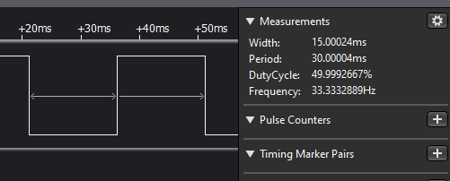

> When the conversion start, the half transfer rise, but the buffer is completely full, and after complete transfer end, the buffer is overwritten.
The ADC doesn't wait for your handler to complete before writing more data. If your conversions are fast, it is expected that more than half of the buffer will be populated by the time you get into your HT interrupt. If your code can't keep up with the rate of conversions, the buffer will be overwritten before you can process it.
Consider slowing the conversions down by increasing sampling time, or by using a timer to trigger conversions.

These are my sampling time calculation:
- 6 channels
- 12.5cycles sampling time
- oversampling ratio 32x
- synchronous clock mode divide by 2
- system clock 64Mhz so the adc clock is 32Mhz
- Buffer 1200, so 600 samples is half buffer, this is equivalent to 100 sequences because 6 channels
Time sampling for one sample: 32 * ((12.5 + 12.5) / 32000000) = 25us
Time sampling for one sequence: 6 * 25us = 150us
Time sampling for half complete buffer: 100 * 150us = 15ms
Time sampling for complete transfer buffer = 30ms
PD: the issue si the same with 32 size buffer or 1200 size buffer.
So there is no sense with this kind of time. This is a slow operation ought to oversampling ratio and 6 channels scanning.
I have a breakpoint in the half transfer callback function, and the buffer is complete in the first half transfer execution.

I am sorry, was a mistake. The compilation has -O2 flag enable so, when i create a breakpoint in the line of enabling adc, this is no created correctly and the function is already finish. So the adc already start the conversion.
However I am still having the issue with buffer filled completely when half transfer dma flag arise.

‎2021-11-26 4:29 PM
To be sure about the time calculation, i put a toggle pin code in half and complete callback functions. Then I snif the pin and the result is very accurate.
