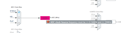

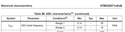

I don't understand why CubeMX is limiting me through their IOC file to select an ADC clock below 2MHz. The datasheet says 140 kHz is the minimum ADC clock frequency for the STM32G07. Anyone has any answers or help ?.

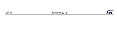

Could you please tell in which datasheet and on which page you found that 140kHz?

Just to tell that CubeMx is shoiwng this warning message:  "ADC clock source must be >= 0,14MHz...." which is inline with the datasheet.
So you need to provide your exact clock configuration so I could reproduce the same behavior as it could be something else..

Hi okay, here is my IOC file. I want a 32 MHz Asynchronous clock input into the ADC.
Then I want to have the prescaler at 128. I then later at a different stage in my application want a high ADC clock speed, so I want to keep the same clock input and then just change the prescaler.
Here is my IOC file, try and select a prescaler of 128 with my clock settings
Ok thank you for the sharing.
I'm escalating the issue internally for further analysis. Internal ticket number 216840 (not accessible by the community users)
