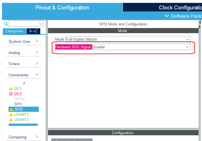

We know it's possible to programmatically toggle GPIO pins and "manually" manage them, but are there any examples of how to do this using NSS?
Not sure I get what you're asking here?
When you're managing it "manually", it's just like setting any other GPIO high and low - so you just do that!
In your .ioc file (CubeMX project) disable the Hardware NSS:

On the STM32F4 SPI, the NSS pin is always low. This is a common complaint but that's just how the hardware was made. If your slave requires something different, you will need to set it as GPIO output and toggle manually. It is okay to do this.
On newer families, the NSS pin can behave how you want, with it going low while the clock is active and high afterwards. This can be useful when there is only one slave, but doesn't help at all when multiple slaves are present.
