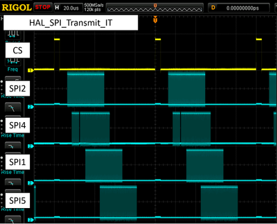

I have an STM32H7A3ZIT running at 280MHz with 4 SPI buses attempting to “simultaneously” communicate with external ADCs. All 4 SPI are set up as full-duplex masters, 16-bit data size, 8.75 MHz clock speed, and software chip select.
I’m using the HAL function HAL_SPI_TransmitReceive_IT to sequentially initiate the data transfer for each SPI bus. I expected each transfer to start quickly one after another, but instead I’m finding large time gaps. The TransmitReceive_IT composite image below shows the chip select line (yellow) and the SPI clock signals (cyan) for each sequential SPI bus. You can see the first 2 buses start clocking quickly, but then there is a time gap before the third and fourth buses start clocking. The code functionally works as the received data is correct, but the end of the transfer for the fourth SPI bus is too close to the next CS transaction, not leaving a lot of time for data processing.
TransmitReceive_IT
Oddly enough, if I change the function to just receiving (HAL_SPI_Receive_IT), then all 4 transactions proceed quickly as I would expect. See the following Receive_IT composite image demonstrating what I would like.
Receive_IT

2026-01-29 12:02 PM
There's nothing wrong with the signals shown as far as the SPI protocol goes. You can have gaps. If you don't want gaps, consider using DMA to send or using more optimized code. Compiling in Release configuration will be faster.
The issue is that interrupts take time to run and HAL_SPI_Receive_IT calls an interrupt for each received word.
Only receiving requires less CPU time than sending and receiving.
You can have the STM32H7 handle the CS line as well to avoid having to do it with a TIM.
Commenting out SPI_CR1_CSTART will prevent the transfer from starting. Not sure I understand the point.

2026-01-29 12:47 PM
@TDK wrote:There's nothing wrong with the signals shown as far as the SPI protocol goes. You can have gaps. If you don't want gaps, consider using DMA to send or using more optimized code. Compiling in Release configuration will be faster.
Are you saying all the receive interrupts are causing it to slow down? If so why is receiving alone running great but transmit and receiving is bottle necking?
@TDK wrote:You can have the STM32H7 handle the CS line as well to avoid having to do it with a TIM.
I have to run it with a timer for fixed-interval sampling. It also has to do with the ADC sampling time.
@TDK wrote:Commenting out SPI_CR1_CSTART will prevent the transfer from starting. Not sure I understand the point.
The point was to test the HAL efficiency. It's commonly accepted that HAL code is bloated, so by running everything except for the very last line (SPI_CR1_CSTART), I could see that the HAL function runs quickly. It's starting/running the transmission that seems to be the problem.
2026-01-29 12:52 PM
@Chris21 wrote:Perhaps the delay is due to having to service all those interrupts from the 1st 2 SPI transfers. There should be less code executed in the handlers for the Receive only case.
(Sorry, I see now that TDK already said the same thing).
As far as I can tell, adding transmission only adds the TxISR to the SPI handle. In the end it either calls the HAL_SPI_TxRxCpltCallback or HAL_SPI_RxCpltCallback.
2026-01-29 1:00 PM

2026-01-29 1:16 PM
Good call. I missed that SPI_TxISR_16BIT and SPI_RxISR_16BIT linked to functions.
I recorded new SPI clock timings with only transmitting (HAL_SPI_Transmit_IT), and it's showing progressively delayed bus starts. What I'm seeing is that transmitting and receiving has delays, transmitting only has delays, but receiving only has zero-ish delay.
Transmit_IT
2026-01-29 1:26 PM
Your system has so many interrupts it's surprising it works at all.
Why not use DMA, as TDK mentioned?
2026-01-29 2:41 PM
rx plus tx is twice as much code. If rx interrupts start happening before all transmissions start, you see the delay. That is what you are seeing.
Very inefficient to have an interrupt on each word. If all data fits in the fifo this could be done very quickly but of course Hal is set up for the general case, not specialized applications.
