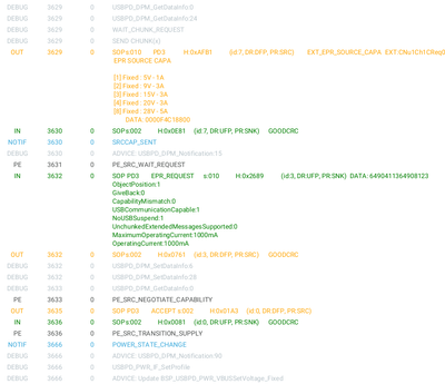

Hi, I'm trying to implement USBPD EPR Source with DisplayPort Alt Mode on a STM32G071.
I use the latest https://github.com/STMicroelectronics/stm32-mw-usbpd-core, which seems to support EPR, but I couldn't find any complete examples with a working EPR source.
Now I successfully enter EPR mode, and Sink receives EPR PDOs, but can't negotiate any PDO except the 1st. Even SPR PDOs
The stack sends REJECT after PE_SRC_NEGOTIATE_CAPABILITY.
It works perfectly in SPR mode and can switch between PDOs, but fails the same PDO in EPR mode
1st PDO in EPR mode ACCEPT:

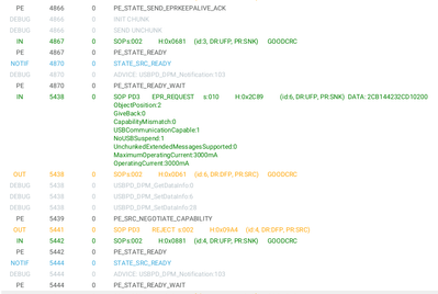

2nd PDO REJECT:
How can I debug these things inside the stack? What am I missing?

After creating a topic, I found my bad in USBPD_PWR_IF_SearchRequestedPDO while in EPR mode.

FBL
Hi @xGloooM
To create EPR request STM32 as source:
  1. Initialize EPR PDOs properly by creating your EPR Source PDO PORT0_PDO_ListEPRSRC following the USB PD3.1 (or 3.2 depending on your stack, as of now I guess we support only 3.1) AVS PDO format (voltage in 25 mV units, current in 50 mA units).
  2. Assign this PORT0_PDO_ListEPRSRC and its count to the EPR PDO storage in USBPD_PWR_IF_Init.
  3. Enable EPR Source support in DPM_Settings for the port to inform the PE and stack .Is_EPR_Supported_src=USBPD_TRUE,
  4. Ensure USBPD_PWR_IF_GetPortPDOs supports USBPD_CORE_DATATYPE_SRC_PDO_EPR to handle PDO retrieval for EPR.
  5. In USBPD_PWR_IF_SearchRequestedPDO, check if the requested RDO position corresponds to an EPR PDO.
  6. In USBPD_PWR_IF_SetProfile,  set voltage/current to process the selected PDO type when the device receives a power contract request RDO to handle EPR voltages and currents properly (up to ~48 V).
About the error message from trace, it means nothing, you have just received the status.
Best regards,
FBL
