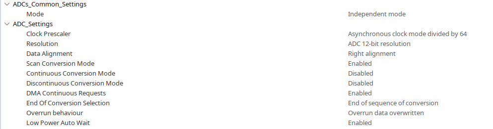

I'm using ADC1 to measure the Temperature Sensor channel and the Vrefint channel. I expect those to vary very slowly and I am in not in a hurry so I am maximizing the sampling time. These are my settings in STM32CubeIDE:
It generates the following in main.c:

  /** Common config
  ADC_InitStruct.Resolution = LL_ADC_RESOLUTION_12B;
  ADC_InitStruct.DataAlignment = LL_ADC_DATA_ALIGN_RIGHT;
  ADC_InitStruct.LowPowerMode = LL_ADC_LP_AUTOWAIT;
  LL_ADC_Init(ADC1, &ADC_InitStruct);
  ADC_REG_InitStruct.TriggerSource = LL_ADC_REG_TRIG_SOFTWARE;
  ADC_REG_InitStruct.SequencerLength = LL_ADC_REG_SEQ_SCAN_ENABLE_2RANKS;
  ADC_REG_InitStruct.SequencerDiscont = LL_ADC_REG_SEQ_DISCONT_DISABLE;
  ADC_REG_InitStruct.ContinuousMode = LL_ADC_REG_CONV_SINGLE;
  ADC_REG_InitStruct.DMATransfer = LL_ADC_REG_DMA_TRANSFER_UNLIMITED;
  ADC_REG_InitStruct.Overrun = LL_ADC_REG_OVR_DATA_OVERWRITTEN;
  LL_ADC_REG_Init(ADC1, &ADC_REG_InitStruct);
  LL_ADC_ConfigOverSamplingRatioShift(ADC1, LL_ADC_OVS_RATIO_256, LL_ADC_OVS_SHIFT_RIGHT_8);
  LL_ADC_SetOverSamplingDiscont(ADC1, LL_ADC_OVS_REG_CONT);
  LL_ADC_SetCommonPathInternalCh(__LL_ADC_COMMON_INSTANCE(ADC1), LL_ADC_CHANNEL_VREFINT|LL_ADC_CHANNEL_TEMPSENSOR);
  ADC_CommonInitStruct.CommonClock = LL_ADC_CLOCK_ASYNC_DIV64;
  ADC_CommonInitStruct.Multimode = LL_ADC_MULTI_INDEPENDENT;
  LL_ADC_CommonInit(__LL_ADC_COMMON_INSTANCE(ADC1), &ADC_CommonInitStruct);

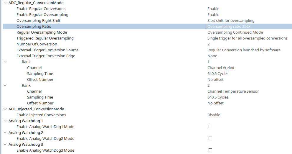

  /** Configure Regular Channel
  LL_ADC_REG_SetSequencerRanks(ADC1, LL_ADC_REG_RANK_1, LL_ADC_CHANNEL_VREFINT);
  LL_ADC_SetChannelSamplingTime(ADC1, LL_ADC_CHANNEL_VREFINT, LL_ADC_SAMPLINGTIME_640CYCLES_5);
  LL_ADC_SetChannelSingleDiff(ADC1, LL_ADC_CHANNEL_VREFINT, LL_ADC_SINGLE_ENDED);
  LL_ADC_REG_SetSequencerRanks(ADC1, LL_ADC_REG_RANK_2, LL_ADC_CHANNEL_TEMPSENSOR);
  LL_ADC_SetChannelSamplingTime(ADC1, LL_ADC_CHANNEL_TEMPSENSOR, LL_ADC_SAMPLINGTIME_640CYCLES_5);
  LL_ADC_SetChannelSingleDiff(ADC1, LL_ADC_CHANNEL_TEMPSENSOR, LL_ADC_SINGLE_ENDED);

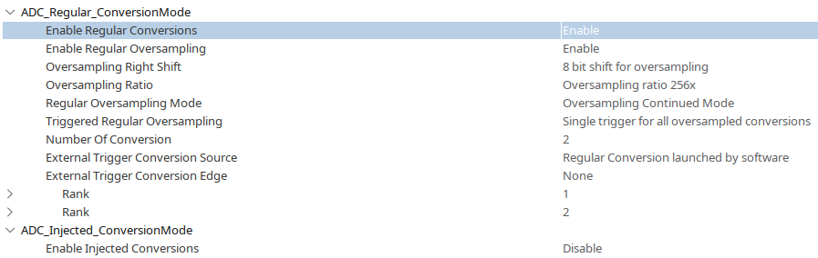

I see it now. Even though I selected Enable Regular Conversions: Enable in STM32CubeIDE:
that, apparently, doesn't do anything. It's up to the user to manually set
Bit 0 ROVSE: Regular Oversampling Enable
This bit is set and cleared by software to enable regular oversampling.
0: Regular Oversampling disabled
1: Regular Oversampling enabled
I added
    ADC1->CFGR2 |= ADC_CFGR2_ROVSE_Msk;
to my initialization function and now I am getting "EOS wait: 445799 us", which is what I expected in the first place.
I added
