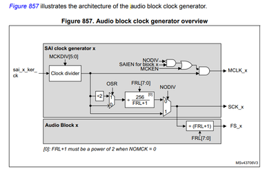

As the SAI clock generator described in the STM32U5 reference manual (RM0476):
On HAL SAI source code, depending on the audio frequency asked, MCKDIV is computed.
Computation of MCKDIV depends on asked audio frequency (Fs), frame length (FRL), SAI kernel clock (Fk), master clock no divider parameter (NODIV) and master clock oversampling (OSR):
If NODIV = 1 :
    MCKDIV = Fk / (Fs x FRL)
If NODIV = 0 and OSR = 0 :
    MCKDIV = Fk / (Fs x 256)
If NODIV = 0 and OSR = 1 :
    MCKDIV = Fk / (Fs x 256 x 2)
For specific case of SPDIF protocol, the bit clock must be twice the symbol-rate, so MCKDIV is also divided by 2.
So, for specific SPDIF case, the previous formulas become:
If NODIV = 1 :
    MCKDIV = Fk / (Fs x 64 x 2)
    MCKDIV = Fk / (Fs x 256 x 2 x 2)
It's recommended to configure the SAI kernel clock in order to have as much as possible, an integer value of MCKDIV.
It means for specific case of SPDIF, to configure SAI kernel clock as follow:
If NODIV = 1 :
    Fk = N x (Fs x 64 x 2)
    Fk = N x (Fs x 256 x 2)
    Fk = N x (Fs x 256 x 2 x 2)
Because master clock no divider (NODIV) and master clock oversampling (OSR) parameters are not available on SAI configuration panel. These parameters are initialized to 0. It means that you need to configure a SAI kernel clock as a multiple of (Fs x 256 x 2).
Therefore, for an audio frequency at 48KHz, you need to configure SAI kernel clock at around N x 24,576Mhz.
Nevertheless, we will work to resolve the issues on CubeMX side, to add missing parameters and correct information displayed on SAI configuration panel:
1- Add those two parameters "Master Clock No Divider" and 'Master Clock Oversampling" in the list of Parameters settings when SPDIF protocol is selected for SAI in order to calculate the right "Real Audio Frequency".
2-"Master Clock Oversampling" parameter has also to be added when SAI mode is set as "Master" or "Master with master clock out".
Hope my answer is clear!

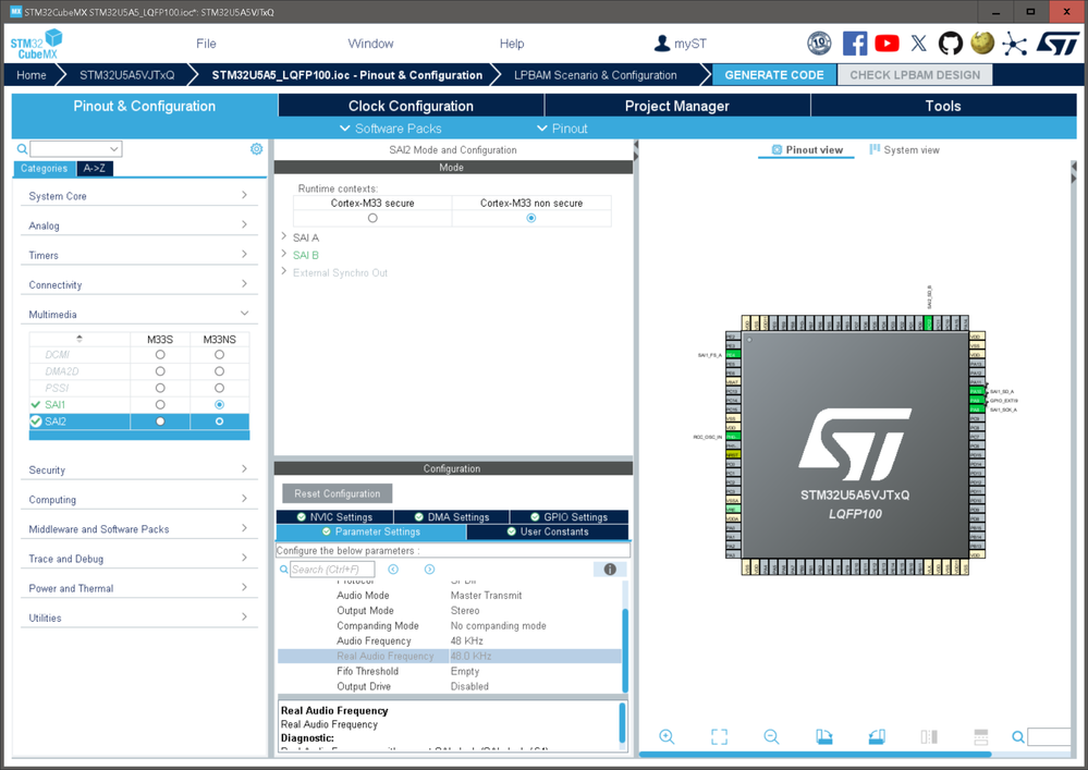

What I did in CubeMX (and maybe you can replicate):
  • create a project for a STM32U5A5 LQFP100 package (because, this package has SAI2 pin configurations, the LQFP64 does not, even the same pins are there and potential possible to use as SAI2_B SPDIF, what I try to get working)
  • setup SAI2_B, with PC12 as SPDIF output
  • trim the clock config for SPDIF (SAI2_B) so that the error for audio frequency is minimum (48KHz, stereo): my HSE XTAL is 8MHz (not 16MHz as on Nucleo board) - check if "Real Audio Frequency" is reported as the correct one, with the smallest error
My entire FW project is here (not the CubeMX project, my real IDE project, see my clock config there):
https://github.com/tjaekel/NUCLEO-U5A5JZ-Q_QSPI
Here the CubeMX config done (for a STM32U5A5 LQFP package, as reference):

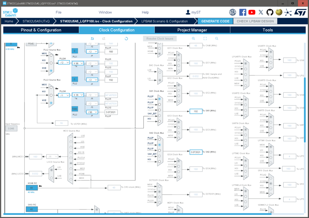

Trim the SPDIF clock config for "best" "Real Audio Frequency" - it is wrong (even it shows me perfect 48KHz).
The clock configuration: SAI2_B, PC12, using PLL3_P, with HSE 8 MHz XTAL - resulting in correct "Real Audio Frequency"
But it is (for sure) wrong:
  • yes, 48KHz, 32bit samples (as needed for 24bit plus bits for SPDIF, always 32bit on SPDIF), two channels, results in 3,072 KHz clock for sai_clk (here)
  • but SPDIF needs the doubled frequency: so the sai_clk must be at least 2x the audio frequency, so that MCLKDIV can be set to 1 (or 0), or any N times multiplied clock would be fine
  • the reported PLL setting is not right for SPDIF
The IOC file for SPDIF config is here:
https://github.com/tjaekel/NUCLEO-U5A5JZ-Q_QSPI/blob/main/STM32U5A5_LQFP100.ioc
I will close as solution when you (STM team) can confirm how to configure SPDIF via CubeMX.
Thank you.
