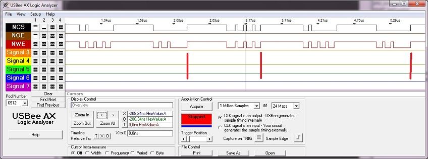

Hi. All!
I want to use FSMC module, but I'm not sure that it settings correct. There is write operation on a picture. I see multiple NWE activation. And sometime it release NEx together NWE (should be NWE and than NEx). What should I do for diagram like Figure 437 from
http://www.st.com/st-web-ui/static/active/en/resource/technical/document/reference_manual/DM00031pdf?s_searchtype=keyword
? Or, possible, I don't understand something? 0690X00000602yqQAA.jpg Code:

At 24 Msamples per second you are probably not capturing single write pulses - if you run the mcu at 168MHz, they should last around 40ns. Show us also the capture of your ''marker'' signal, not hand-drawn lines.
Also, I don't speak the library gobbledygook, but it appears to me that you set FSMC for multiplexed memory but you don't initialize FSMC_NL, I suspect you do this in error.

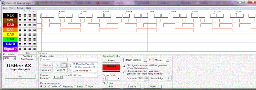

Thank you! You was right - samplerate was too low. It worked on default frequency - 16MHz HSI (not 168MHz, of course! ), but samples couldn't show all details. For 16MHz need 32MHz sample frequency minimum (as told Nyqist and Kotelnikov).
I added
RCC_HCLKConfig( RCC_SYSCLK_Div4);
// make it slow
and now I have this one.
Black - NEx,
red
- NWE,
brown
- soft strobe (see source upper):
Hah! I can do the same over registers, but library (SPL) do writing code simplier and help me study new MCU faster. Possible, code using library isn't readable for you - sorry.
but it appears to me that you set FSMC for multiplexed memory but you don't initialize FSMC_NL, I suspect you do this in error. Can you explain it more detail? What means 'multiplexed' for FSMC? In my appinion, it means that data and address used the same wires. No? Not only? When need FSMC_NL signal? I don't need it really. But ,if FSMC_NL can separate address and data - it will be great! Now I want to use just A8 bit.
