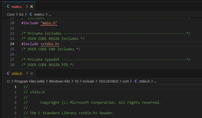

7. Went to main.c and typed "include <stdio.h>". Open it's definition. Since I have Microsoft Windows SDK installed, it found stdio.h from there.
8. Include something more embedded, like <elf.h>. It's not found:

12. Restart clangd and re-open main.c. It detects right path:
13. See clangd output. There's more stuff than before:
