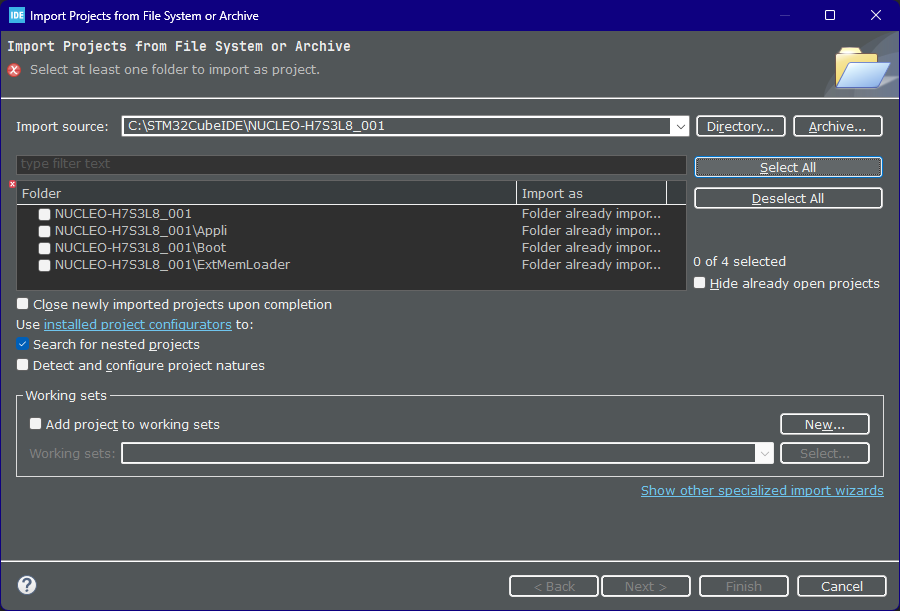

I'm missing the "Build All" option, which allows you to build all three projects simultaneously and start the application after flashing without having to press the reset button. I think so.
This is the first time I've used a bootflash MCU, and I'm sure I've missed something.
I've attached the IOC file, which only shows a blinking yellow LED.
Why do I need to reset the board to start the application?
Update 1:
There's a "Build All" button in the toolbar that performs this task. But it does this for all projects in the workspace.
I usually have several projects in one workspace, so I don't need to re-adjust my entire workspace, such as the dark theme, colors, fonts, etc. That's not always handy, especially not when refactoring variable names.

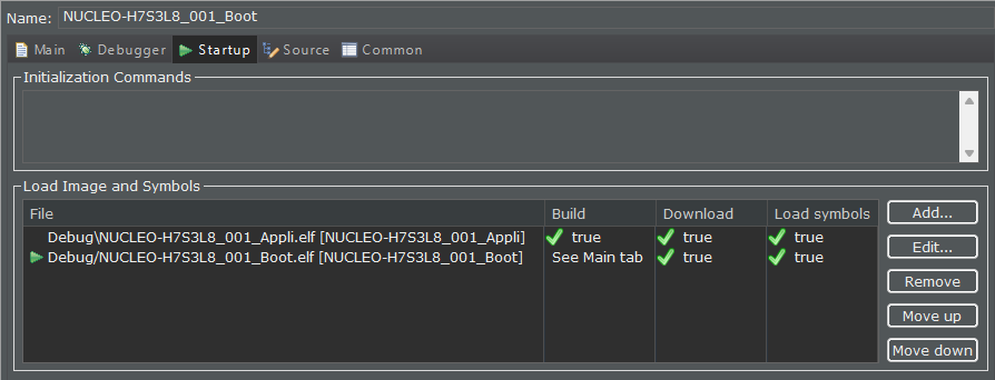

Regarding the need to press the reset button to launch the app, I've fixed that as well.
In the app's debug configuration, on the "Startup" tab, I had to add the bootloader.
Make sure they are in the correct order to avoid a hardfault when starting debugging, like shown below.
For the application it should look like this:
And for the bootloader it should look like this:
That was all folks, cheers, and happy debugging!
Solved.
