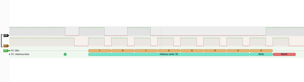

Hooking my code to a logic analyzer I can see that the master device sends the correct address, 0x50.  But followup data is ignored.  (I changed the I2C address in the code from 0x08 to 0x50.)
I used the following command line to send data to the device:
i2cset -y 8 0x50 0x01 0x02 0x03 i
and I receive
"Error: Write failed"
I know I'm missing something in my code.  Any suggestions would be appreciated.
-A
As @Ozone said, are you sure that 0x50 is the correct 7-bit address?
More on common & widespread confusion & misrepresentation of I2C addresses:
https://community.st.com/t5/imaging-sensors/vl53l8cx-not-working-on-nrf9151-and-getting-naks/m-p/814452/highlight/true#M5697
Which very much suggests that the address is not what the slave is expecting.
Have you tried just doing a scan of all possible I2C addresses?
Again, Have you looked at ST's examples for the stm32g0 ?
Have you used an oscilloscope to verify that the signal is good in the analogue domain? If it's not, the LA won't be giving useful information.
