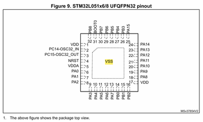

Which pin is the VSSA of STM32L051K8U6?

The UFQFPN32 package doesn't have a dedicated VSSA pin. The VSSA pin is double bonded to the VSS pin internally which is connected to the exposed pad.
