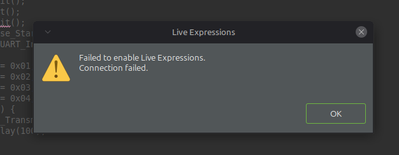

CubeIDE 1.19.0: Failed to enable Live Expression. Connection failed
Gaston
Senior
This does not happen in CubeIDE 1.15.1 and the solution suggested in this post does not work either.
How can I fix this issue?
Thanks in advance,
Gaston

It says, "Connection failed" - can you do anything else in the debugger?

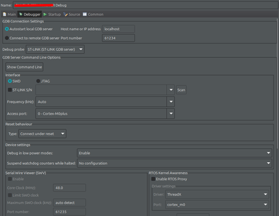

Souhaib MAZHOUD
Hello @Gaston
Could you please share your Debug configuration, or your Log file?
KR, Souhaib
Where is the Log file?
Here's the Output Console

and the Debug Configuration

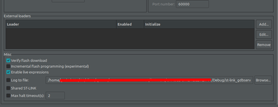

Gaston
Just check "Log to file" in debug configuration so you can find your log.
Could you try to test with OpenOCD and check if the issue persists?
I've debugged my application with OpenOCD. With this option I'm able to see Live Expressions as usual.
Here's attached my STLINK GDB Server log file: The option that shows the Failed to enable Live Expression message.
