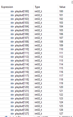

In my reception array I have only a part of data, and yet my TX table is well initialized like this :

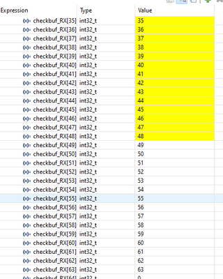

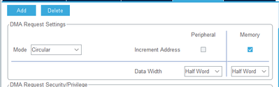

After decreasing the size of the table to 128, and modify the DMA configuration for TX and RX like this :
In the Main I have something like this :
  while (1)
    /* USER CODE END WHILE */
		 if( dataReadyFlag_1)
		   processData_1();
		 if( dataReadyFlag_2)
		   processData_2();
    /* USER CODE BEGIN 3 */
And in the processData_1(); I fill half of the table and the same for the second half of the table.
void processData_1 ()
{	for (int32_t n=0; n<(BUFFER_SIZE/2); n++)
	{checkbuf_RX[n]=playbuf_RX[n];}
	dataReadyFlag_1=0;
For the processing time I am on time. With 110 MHz (time of a clock cycle). I'll have
2x128x1/(110.10e -6) = 2.3µs x 4 (factor) = 9.3 µs which is less than 27µs. But I have only half of the data, looks like the other half is not working. I certainly forgot a few things but what ?
And yet my TX table is correct

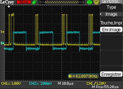

For the scope I have (yellow : data. blue : FS)

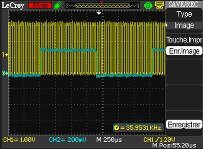

To check that both flags are set: in processData_1() (better call it "half" or so than "1") set a GPIO high, in processData_2() (better call it "full" or so than "2") set the same GPIO low again. If both flags are set and reset again, the GPIO should toggle with a rate equal to sampling rate / buffer size. Check with scope.
I'll come back with the curves.The result is not there but I have values.
yellow :FS / blue : led flashing
My sample rate is 44.1 kHz (real : 35.7 kHz). So sampling rate/128 = 278 Hz (about), but I have 571 Hz (about twice as much). I'm Debug mode and maybe in Release mode that would change something ?
