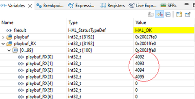

I am not receiving some of the data, do you know where I can find the documentation to implement SAI blocking mode? thanks in advance.

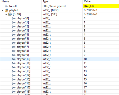

In my reception array I have only a part of data, and yet my TX table is well initialized like this :

You need to understand what's going on there:
- HAL_SAI_Transmit() seems to return when data transfer to the SAI's FIFO has finished
- HAL_SAI_Receive() is started when there is only the data in the TX FIFO
Again, DMA is for most applications the best solution.
Anyway, isn't there some combined start function for TX & RX? Check the SAI HAL file...

If you had taken a closer look at HAL_SAI_Transmit(), you would have seen that it returns only after the transfer has completely finished.
Anyway, what you show as DMA init is not what I meant, I meant the SAI / DMA init, where you set circular mode and so on. If the DMA transfer runs only once there's some bug in your code.

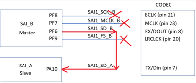

Just one think, I used this configuration in my previous post :
Can I use this same method : Connecting TX with the RX (so for the moment the CODEC is of no use to me). Can I code (circulaire mechanism, IRQ...) with this configuration before actually plugging in the CODEC ?
LCE
Principal II
Sure, why not?
IMPORTANT: do not only rely on software tools, monitor the SD TX pin with a scope. And as I said before, trigger scope on FS = LRCK.
And focus on getting the TX part running continuously via DMA. Only then start the RX part.
It seems you try to do too much different stuff at once, it seems. ;)
