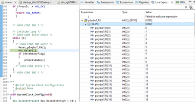

But something is wrong, in my playbuf_RX array is never reset to 0 yet I enter it in the void Reset_playbuf_RX function.
Probably it runs continuously via the DMA and I don't have control of the playbuf_RX?

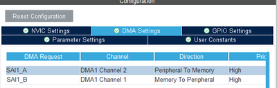

I don't understand where the DMA data is stored ? In my configuration SAI1_A (the slave : CODEC)
Peripheral : SAI_RX
Memory : ? Where and how to read this datas when the Flag RX =1 (HAL_SAI_RxCpltCallback, I make a mistake here).

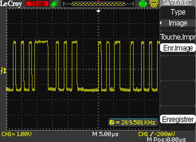

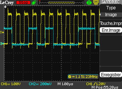

I have 2 signals (blue : data (probe x10). yellow : LRCLK)

Scope:
Your scope does NOT show LRCK ( = FS in STM lingo), but probably SCLK ( = CK or so, the bit clock).
LRCK frequency equals the sampling rate, and within one half period you should see one data sample.
If you have 3 channels, then simply add LRCK, and trigger on that.

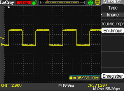

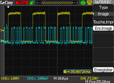

For the scope you're right about FS (yellow) Data (blue) now I have this :

Scope: now that looks better!
I guess that there's some up-counting going on, because only the LSBs are changing.
LRCK ~= 36 kHz - is that what you expected from your SAI TX settings?
At 36 kHz, one sampling period is about 27 µs. Check how many buffers you could read or reset within that time, depends on your CPU clock. As a rule of thumb, take factor 4 for each for loop iteration.

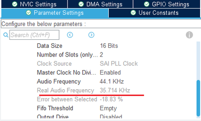

Thank you very much for this very useful information (at least for me). I think after my configuration the LRCL is correct (Real Audio Frequency ?) :

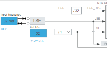

I think my CPU clock is 32.768 kHz about 30 µs.
2 instructions x 8192 x 27 µs = 0.44 s x 4 (factor) = 1.7s. I think the best method is to do is to read 2 halfs buffers, I'll modify the configuration via '.ioc' to do it. I'll see how to deal with interruptions.
Hopefully not!
Maybe find some basic tutorial about STM32 / clock setup.
What you show is the LSE, which stands for Low Speed External clock, that should only / mostly be used for a real time clock (RTC).
Your CPU clock should at least be in the MHz range, which STM32 type + board are you using?
CPU clock source should be somewhere from HSI (not good for audio due to jitter) or HSE.

After reading some information about the clock I understand a little better. My CPU clock is 16 MHz
For the moment my objective is just communication by SAI, after of course I need to optimize my electronic board. I have an evaluation board : STM32L552E-EV with STM32L552ZET6QU microcontroller. I understand the 'HALF complete interrupt' after your explanation and I'll implement with this method. You're right, I've to reduce the size of my array just to see at first, for example an array of 100 values.
