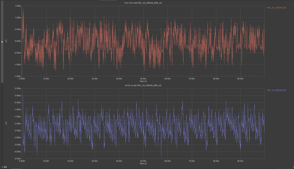

We are trying to run a signal integrity simulation of STM32H747IGT6 in Altium Designer. However, all of the reflection waveforms for signals driven by the device are around 0 volts (basically noise, no driver). We've noticed there is some errata for other IBIS models in this product family. Are there any known issues with this IBIS model? Or can someone recommend a remedy?
We are using "stm32h747_757_lqfp176.ibs" downloaded from: https://www.st.com/en/microcontrollers-microprocessors/stm32h747ig.html#cad-resources.
Thanks!

slc2015Author
September 18, 2023
Here is a screenshot of the waveform with the model from ST.
STOne-32
September 19, 2023
Dear @slc2015
Indeed , it seems only Noise.
The Signal Integrity Analysis capabilities are available through an Altium Designer Signal Integrity Analysis system extension, which is not installed with Altium Designer by default.
I believe we need to engage discussion with Altium partner to see how to configure our IBIS model with Altium IBIS model readers, It may happen not compatible with the IBIS versions that we need to check.

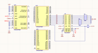

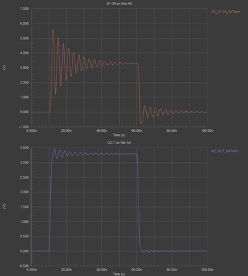

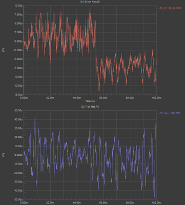

I'm trying to perform signal integrity analysis in Altium too, but for STM32G474MET. I'm using the official stm32g471_473_474_483_484_lqfp80.ibs and I see very similar results on simulation, everything is just noise and no signal. Also for this package there is an extra pin 0 - GND, which is not existing for this package. The extension is already licensed and installed on the latest AD24 platform. The error occurs only when the MCU is the driver. When the MCU is defined as input I can see results (however I still couldn't validate the signals as the PCB is not realized yet.).
Schematic:
Driver MCU, receiver: 74LXC8T245
Driver: 74LXC8T245, Receiver: MCU
The pictures above are from a synthetic test project, that's why the pulse is so ringing.
