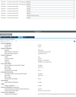

This is my GPDMA configuration:

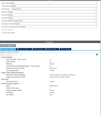

This is my PWM configuration:

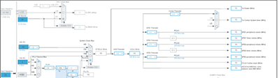

This is my Clock configuration:

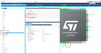

hello,
I have tried to test PWM on pin PB1 (TIM3 CHANNEL4) and PWM is not generated. With the same configuration, PWM works on pin PD15 (TIM4 CHANNEL4). The ST configuration allows me to set it up, but could it be that this pin does not support PWM?
With pin PD15, where I have been able to configure PWM successfully, DMA still does not work. What could be the cause of this?

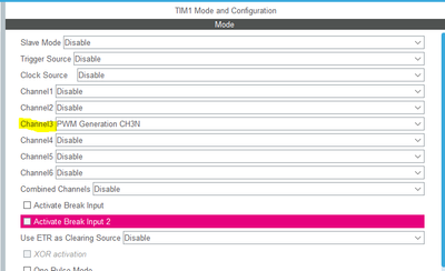

Hello @JonConesa
Try using TIM1_CH3N on PB1

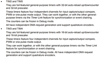

JonConesa
I'm sorry for taking so long to respond.
I have a custom board with the STM32F563VGTx MCU. That's why I chose Timer 3 CHANNEL4, as it turned out to be the most suitable option for routing. Furthermore, when testing Timer 5, it worked correctly in generating PWM through DMA. Is it possible that I can only generate DMA with Timers 2 and 5?
