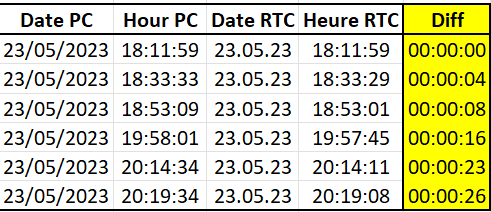

Hi I am having lags in the RTC after one day.
I am currently using the Nucleo L476RG board, the RTC oscillator is LSE and my CubeIDE version is 1.6.1. It seems as if in the time intervals where I do not read the RTC it is not updated. The next table shows the difference between the PC hour and the RTC hour. Here is a part of my code:
A brief explanation of my code. It compares the date and time of the RTC with a file stored on the SD card. Then, if it is at the right timae, it writes the date and time to a data log and sends a data through the UART 4. Then it waits X time (using the getTicks function line 47).
My interest is that there is no delay between the RTC and the real time.

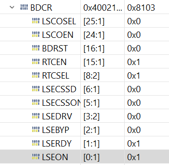

Did you reset the board between these readouts?
Read out and check content of RCC.BDCR register to find out if it's true.
2023-05-24 06:54 AM
No, the board has not been reset. In the log file every time the board starts it prints a "Hello project start". This message appears only once.

Read out and check content of RCC.BDCR register to find out if you indeed run it from LSE.
2023-05-25 03:44 AM - edited 2023-11-20 04:44 AM
These are the values. The bits are well configured, as I read in the manual.
Can you help me ?
2023-05-25 04:50 AM
Yes, RTCSEL=1 is OK.
This means that your LSE runs erratically.
