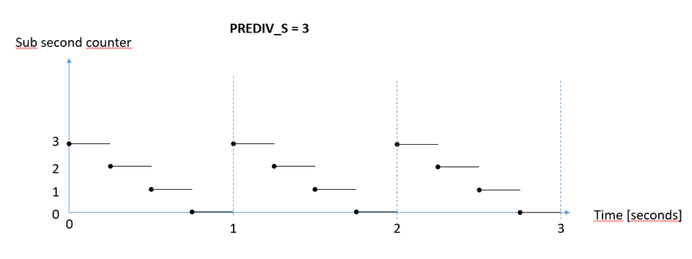

Is this correct about the RTC and the sub second counter
MSipo
Senior II
I'm using an STM32L051.
Is this how the sub second counter works in the RTC? The sub second counter always starts at PREDIV_S when a new second starts?
The graph shows a simplified example when PREDIV_S is 3.

Which STM32?
Yes. However, note, that reading it out properly may be tricky.
Thanks for your link. This was good information.
