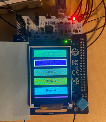

I have a problem when using scroll list as a menu list. I have a custom container( a textArea and a background image) for this scroll list. It works good but this lagging problem.
I'm running on NucleoG071RB + X-NUCLEO-GFX01M2, I know this resources are quite limited in this board. I tried to make the background as a 200*4pix thin line, still has this lagging problem.
Any thoughts? thanks in advance.

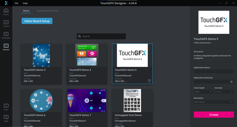

Instead of using Scroll List and animating your background, use Scroll Wheel that supports a template for the selected item.
You can take a look at TouchGFX Demo 5, in the language selection screen, you can see how it scroll wheel is used.
TouchGFX Demo 5TouchGFX Demo 5

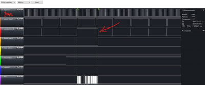

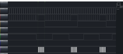

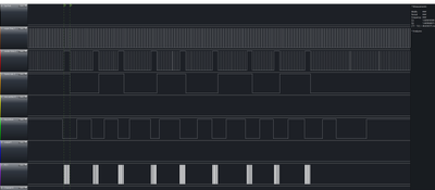

I did a test on my previous scroll list example, I pushed the 'down' button three times quickly in 0.7s and captured this waveform:
Zoom in:
(ch0 is 1ms systick, 1~4 are following nucleo's settings :

From the waveform above, I can see the animation was done in a single cycle which max out the rendering time, causing the lagging effect.
I am thinking, I only changed 1/10 of the screen, which is way less than the band and cpu capability. Is there any setting I can use to fix this? I've tried this below but it did not work at all.
scrollList1.setAnimationSteps(0);//set 0 to disable moving animation, default=30, which is slow to eyes.

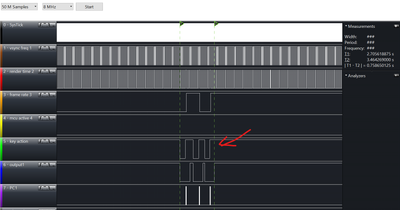

Good, I flashed and tested the effect, and I think it's very good.
I measured the time performance:
The animation takes 3 cycles (of frame) which is why the lagging problem was solved.
