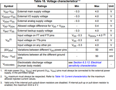

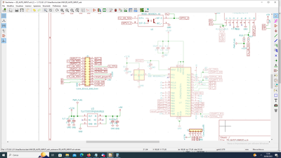

Hello i two questions ,
1) i use mcu STM32F042T6Y a give the same power supply 3.3v to pin VDD,VDDA and VDDIO2, is this a problem?(many gpio(i chose the gipo tollerant) input of mcu work to 5V and i use the usb host of mcu )
2) i want use a external oscillator ASE-8000MHzLCT i connected the oscillator output to PFO and PF1 is flating (not connect),is this corret ? if yes , the oscillator external give me greater stability of interal rc clock ? (i sue mcu as usb host virtual com port)

Hello @Fabrizio70 ,
1)
You should also respect the the maximum allowed injected current values.

‎2023-08-30 6:33 AM
I have VD VDDA Vddio2 are same voltage so i think that have respect table 18.
For input voltage i have 5v on the gpio FT so if i understand the maxim volge on FT pin is VDDIO2+4=3,3+4=7 V (I DONT HAVE INTERNALL pull-up/pull-down)
For the the maximum allowed injected current values i dont understand the table 19 my conditon is this :
VIN =5 VDDIO2 =3,3 V so i have VIN > VDIDDO2 ( positive injection)
the table 19 if i understand give me a current positive injextion 0 mA , seem that dont have problem VIN =5V , it is right or i must use voltage traslator ?
