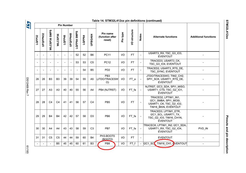

I have use stm32l412cbt6 PB9 to input function and i can get the input data,then i configure PB9 to alternate function GPIO_AF14_TIM16 and i can not get the input data.Under the same configuration,PA3 alternate function GPIO_AF1_TIM2 can get the input data.Please give me some advice.

Maybe there's an error in the the 'L412 datasheet, the AF14 column for PB (and PC) compared to other 'L4 appears to be shifted down one position.
TIM16_CH1 appears to be at PB8 AF14. See also the pin definitions table.
@Imen DAHMEN , can you please check if this is the case?

I reread the manual from ST official website,the table show that PB9 alternate function AF14
2020-03-09 03:56 AM
I see that that's in the AF table; however, as I said above I believe this is an error, because
- it's shifted when compared to other 'L4, and ST usually tries to keep things pin compatible
- the pin definitions table in the same DS also indicates TIM16_CH1 to be on PB8:

i have try a 'l412board and confirm that PB8 alternate AF14
2020-03-10 06:28 AM
You are right, TIM16_CH1 should be at PB8 alternate function AF14 instead of PB9.
We will correct this typo in the coming release of the Datasheet.

2020-03-10 06:29 AM
Thanks, Imen.
Please note, that's not only PB8, but the whole PB and PC in column AF14 are shifted down by one cell.
Jan
