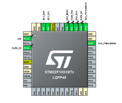

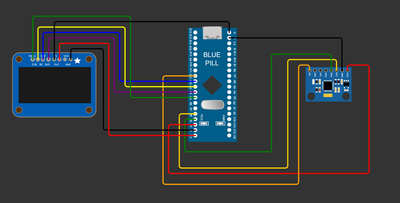

Hello, I'm relatively new to the stm32cubeIDE and currently using it to program a self balancing robot using an stm32F103C8T6 chip.
My current issue is that when i run the SSD1306 OLED display through SPI I am able to display graphics and text as required but as soon as i add the I2C protocol on to the chip the SSD1306 chooses not to display anything. I haven't coded the I2C to read from the MPU6050 sensor as of yet as I am trying to get around this problem as it seems more a I2C bus problem than a specific device problem.
Stm32CubeIDE chip set upStm32CubeIDE chip set up
STM32F103C8T6 Circuit DiagramSTM32F103C8T6 Circuit Diagram
I'm using the SSD1306 library provided by afikson on github (afiskon/stm32-ssd1306: STM32 library for working with OLEDs based on SSD1306, SH1106, SH1107 and SSD1309, supports I2C and SPI)
Not yet got a library or code for the MPU6050.
I should also mention that the SSD1306 CS pin is connected to ground on the module itself (not to the bluepill as seen in the wiring diagram, put it in there for reference) as it is the only device on the SPI bus. On top of that my upload method to the Bluepill is using a USB to TTL connector (pins A9 and A10 are connected to the connector as well as the 3.3V pin and the GND pin the CS pin is using in the diagram). The code i wish to upload is then built and converted to a .hex file from the stm32CubeIDE in order to be uploaded through the stm32CubeProgrammer.

Hello again,
I ran an Blink LED trial to see if the code ran into the while loop, however i also changed the pins as i read earlier today that i2c1 and spi1 remapped do not function together because of an issue with the i2c clock (if i remember correctly). I appreciate your fast reply and efforts to help, thank you greatly.
3 REPLIES 3
Suggests that initializing the I2C creates a pin level conflict, assuming it gets to the code outputting to the screen.
Toggle an LED in the main() while() loop so you can observe if it gets there, or not.
Perhaps use a debugger, step the code, see where it's stuck. Use a scope or logic analyzer.
Check the Data Sheet and Errata, check peripherals and pins associations / commonality.
Thank you for your reply,
simce I'm using usb to TTL I can't use a debugger but I will try the other options and get back to you thank you
Hello again,
