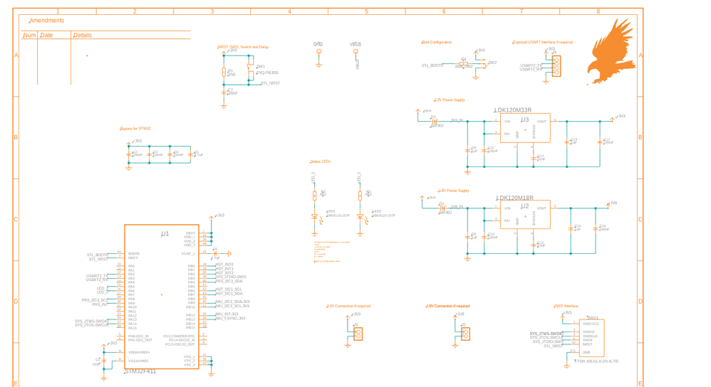

HI TEsla, Ascha,
Here is the relevant part of the Schematic.  It is basically the STM32 chip, an FT201 on i2c, and a couple of test sensors on i2c.  I dont have any i2c elements enabled at the moment as I am trying to narrow the problem down.
I am using an STLink/V2 to connect.
I have had it working on a number of occasions.  But it has been very unreliable.
It successfully programmes it.  If I debug it (F6), it will die at  HAL_TIM_Base_Start_IT. If I Step into that function (F5), it will complete succesfully, but then dies on the next instruction HAL_GPIO_TogglePin.  I cant work it out.
Here are the three most common sources of error on your PCB.
1. bad decoupling
2. poorly soldered connections
3. power supply with high noise or unstable under load
And, I think NRST pin should have a capacitor to GND. Usualy 100nF.
