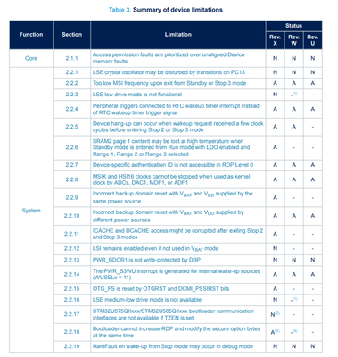

mƎALLEm
All the revision differences are listed in the errata of the product.
A a part of screenshot:
