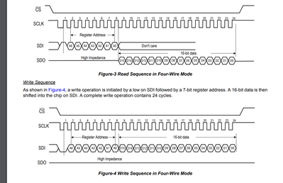

I am working on SPI communication between STM32G491 and ATM90E26. and I am using the SPI polling API with HAL_SPI_Transmit and HAL_SPI_Receive.
My System clock is 96Mhz and I am using prescaler of 64 for SPI.
CLKPolarity=Low,
CLKPhase=1Edge.
Communication is happening between the devices but I am not getting the correct data.
there is only a shift of one bit.

Note that SPI is a bit exchange protocol.  For every bit you send you receive a bit.  So, given the "SPI sequence" you show you must transmit 3 bytes in order to properly set the register address and transfer the 2 data bytes (for either a read or write operation).  You must use a 3-byte HAL_SPI_TransmitReceive() for the register read operation.

I changed SPI prescaler from 64 to 256 ,Now I can able to read correct values from few registers(ATM90E26 is energy meter IC).Now I can able to read frequency & meter status registers correctly. But If I read voltage and current registers I am always getting value zero values.
In ATM90E26 datasheet SPI Interface Bit Rate  max is 160K Bps.
In my configuration 96Mhz(system clock)/256(prescaler)=375 kbps.
Is the issue with Bit rate? Can anyone clarify me ?
Because I can able to read few registers of ATM90E26 correctly & few registers I can't able to read.

Fully I can't share
I am sharing the logic
//write logic
void ATM90E26_SPI_Write(uint8_t addr, uint16_t data)
uint8_t txData[3];
txData[0] = addr & 0x7F;
txData[1] = (data >>8) & 0xFF;
txData[2] = data & 0xFF;
HAL_GPIO_WritePin(GPIOA, GPIO_PIN_4, GPIO_PIN_RESET); // Pull CS/SS low
HAL_SPI_Transmit(&hspi1, txData, 3,100);
HAL_GPIO_WritePin(GPIOA, GPIO_PIN_4, GPIO_PIN_SET); // Pull CS/SS high
//Read logic
uint16_t ATM90E26_SPI_Read(uint8_t addr)
uint8_t txData= addr | 0x80;
uint8_t rxData[2];
HAL_SPI_Transmit(&hspi1, &txData, 1,100);
HAL_SPI_Receive(&hspi1, rxData, 2,100);
// HAL_SPI_TransmitReceive(&hspi1, txData, rxData, 2, 200);
return (uint16_t)((rxData[0] << 8)| rxData[1]);
//ATM90E26 SPI sequence
