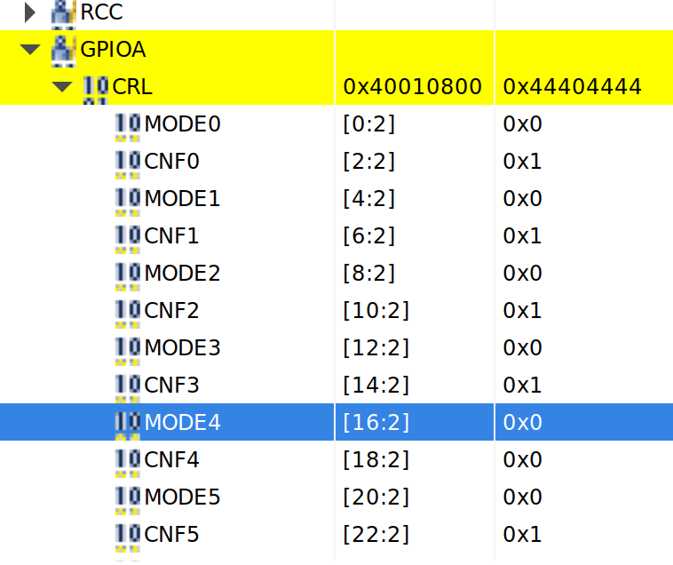

> but when I reconfigured the registers to input pin I found the same 0V
Those pins must be in analog mode.
And VDDA/VSSA and VREF+/VREF- must be supplied with the proper voltages.

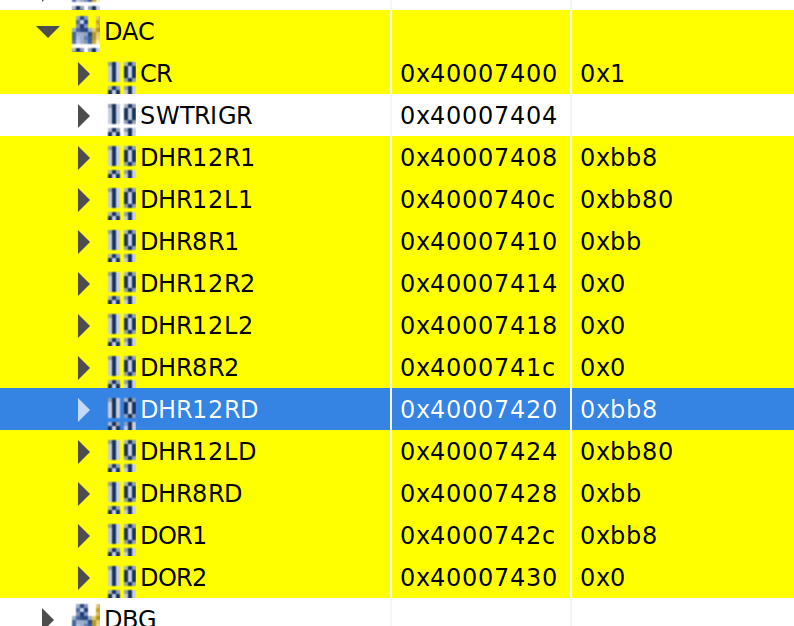

Read out and check/post content of DAC and relevant GPIO registers.

The VDDA pin is to 3.3V. You can see that 3000 ==> 0xbb8 is in the dac register. But 0V on pin pa4. Why ???

Registers look OK.
Have you measured directly on the PIN? Try setting PA4 as GPIO Out and toggle in program while measuring.

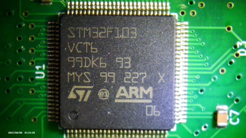

Is this a genuine ST part? Isn't it a counterfeit one? You can check on some of the "known good" boards like Nucleo or Disco.

I tried to toggle the GPIO register on debugging, It works, as output I had 3.3V or 0V depending ODR register, but when I reconfigured the registers to input pin I found the same 0V.

Here is the MCU I use, soldered by jlc pcb. May be you wright, this chip and the others I received are fake. Any one can confirm me that is (or not) a ST part ?
jtozz.1
Thx Piranha, I missundertsood the Vref connection. Vref+/Vref- are not connected to VDDA and VSSA on my package. I added solder to make the connection and it works fine.
