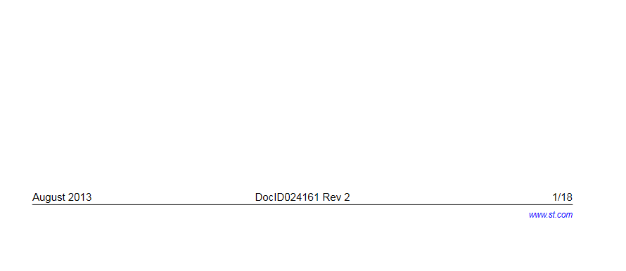

Vinod Kumar
July 26, 2021
0693W00000D0bz8QAB.pngHi Erwan,
I have gone through the page,
www.st.com/en/embedded-software/stsw-stm32126.html#documentation
In this we have AN4235 but the date in the document shows August 2013 DocID024161 Rev 2.
I am basically looking for the updated I2C Application note document to implement the I2C driver.
Thanking you,
Vinod Kumar.

Erwan LE-SAINT
Erwan LE-SAINTBest answer
July 26, 2021
Hi Vinod, there is no update available, this AN is still valid.
Erwan
