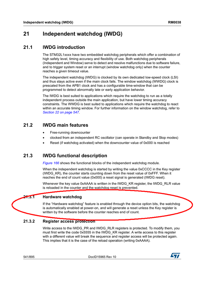

waclawek.jan
> 2 boards are setting watchdog during Powering the Board
0693W00000D1VL4QAN.png?

waclawek.jan
Have you checked the Option Bytes (namely the IWDG_SW bit in them) on those 2 boards?
If the issue is only present on 2 boards and the others are working as they should, I would suspect a hardware defect on those 2 boards (probably from manufacturing).
Since the watchdog is kicking in, I would look for endless loop conditions like waiting for the LSE to startup correctly, or something like this.

waclawek.jan
I don't know what is RCC_FLAG_IWDGRST.
I am asking about the Option Bytes, i.e. nonvolatile bytes which may be programmed during device programming.
