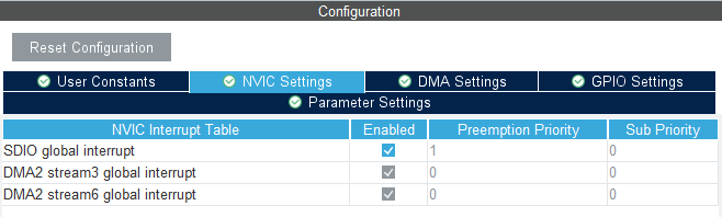

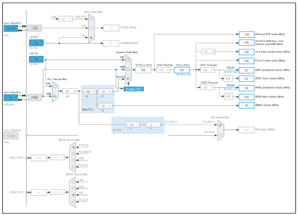

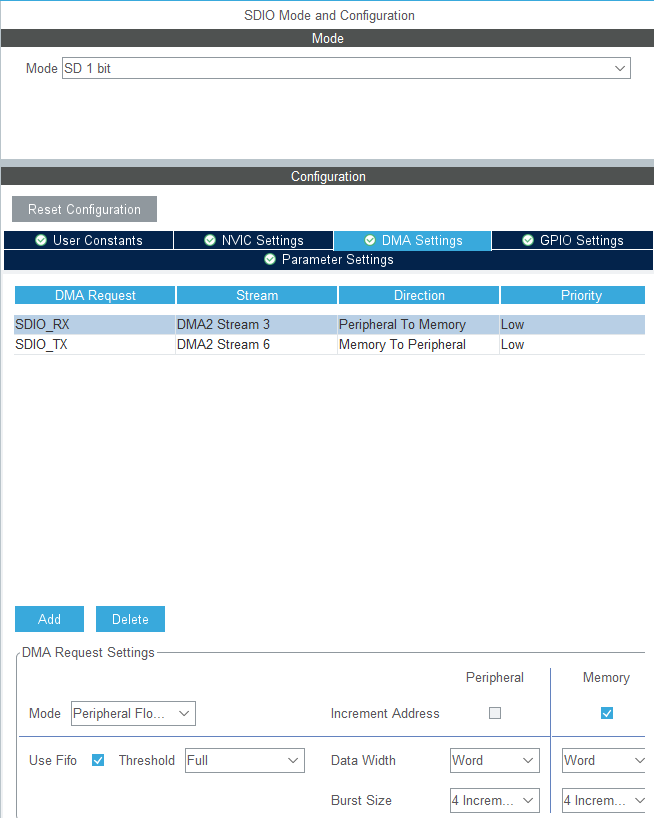

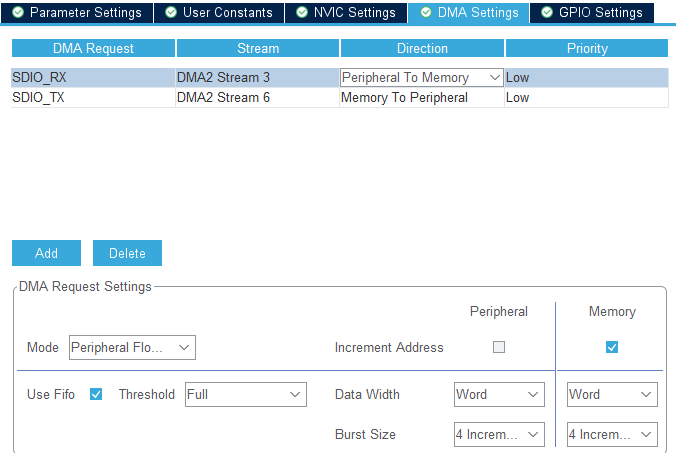

Now, 1 bit + DMA mode, that's not working well. It reads fine, creates files, but ALWAYS double writes things to files!
  • Pull ups enabled or disabled, it doesn't make any diffrence
  • DMA template - enabled

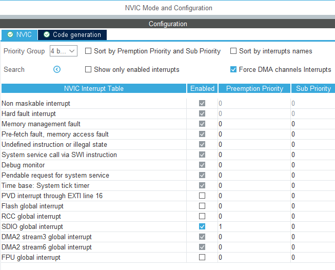

0693W00000D1bYdQAJ.pngNow a little comment on the priority: I tried setting SDIO global interrupt preemption priority to 1 so it would be lower than dma's interrupt, but it didn't work.

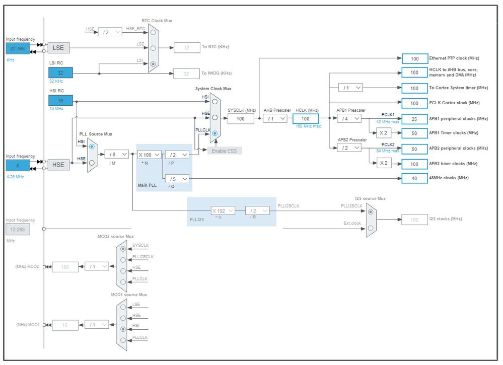

Clock configuration the same as in the previous example.
Also, I tried decreasing clock speed on SDIO, by setting APB2 to 24MHz, or by increasing the CLK divide factor - it didn't help.

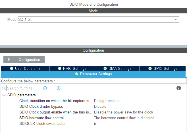

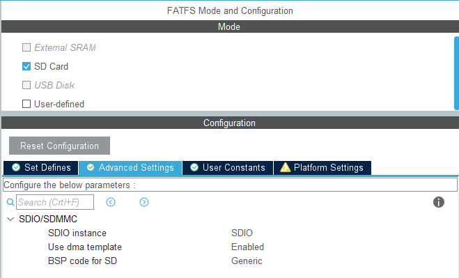

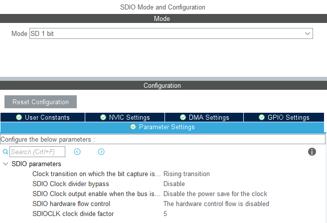

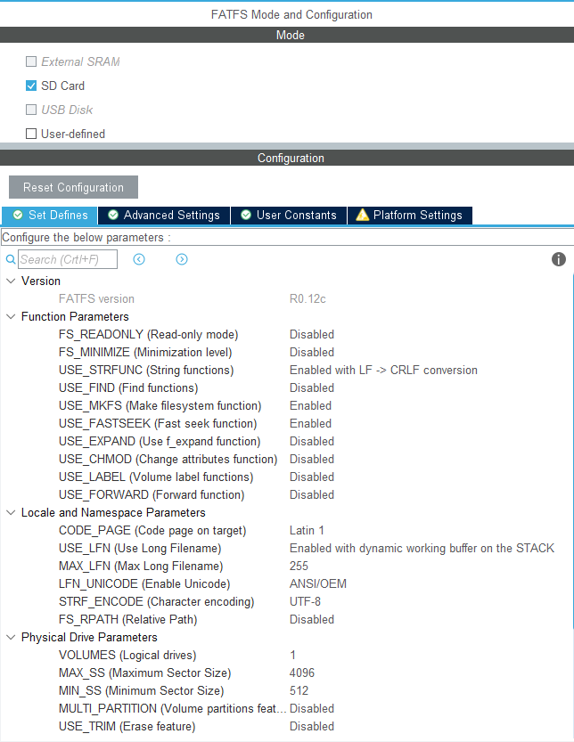

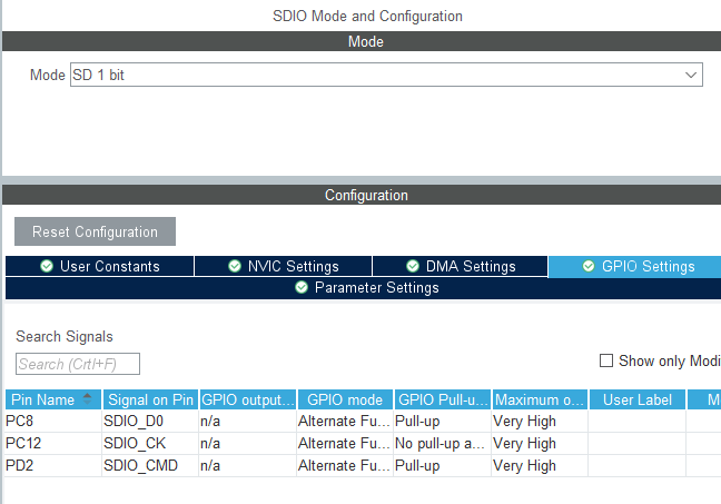

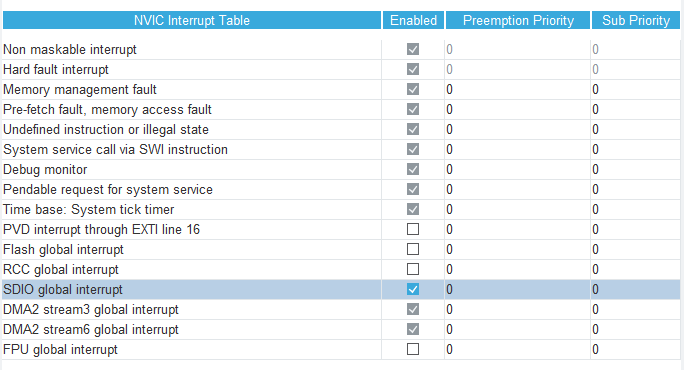

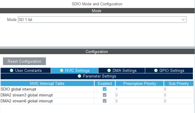

UPDATE:
I got 1bit+dma to work. Here is my config in CubeMX for anyone struggling too:
0693W00000D1htrQAB.png0693W00000D1htmQAB.png0693W00000D1hthQAB.png0693W00000D1htcQAB.png0693W00000D1htSQAR.png0693W00000D1htNQAR.png0693W00000D1htIQAR.png0693W00000D1ht8QAB.png

UPDATE:
bmak
Senior
Also, my 4bit+dma started working. Turned out that printf blocked it. :)
