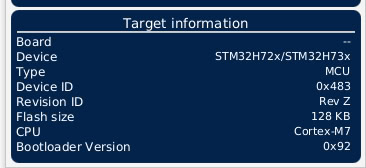

Device details :
ST-LINK SN : 30001100140000363132524E
ST-LINK FW : V2J45S7
Board : --
Voltage : 3.25V
SWD freq : 4000 KHz
Connect mode: Hot Plug
Reset mode : Software reset
Device ID : 0x483
Revision ID : Rev Z

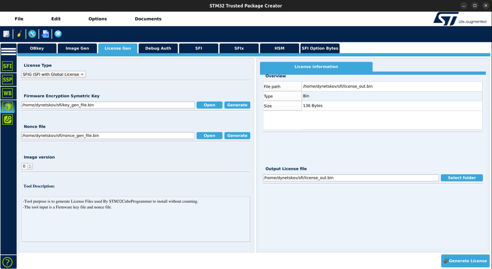

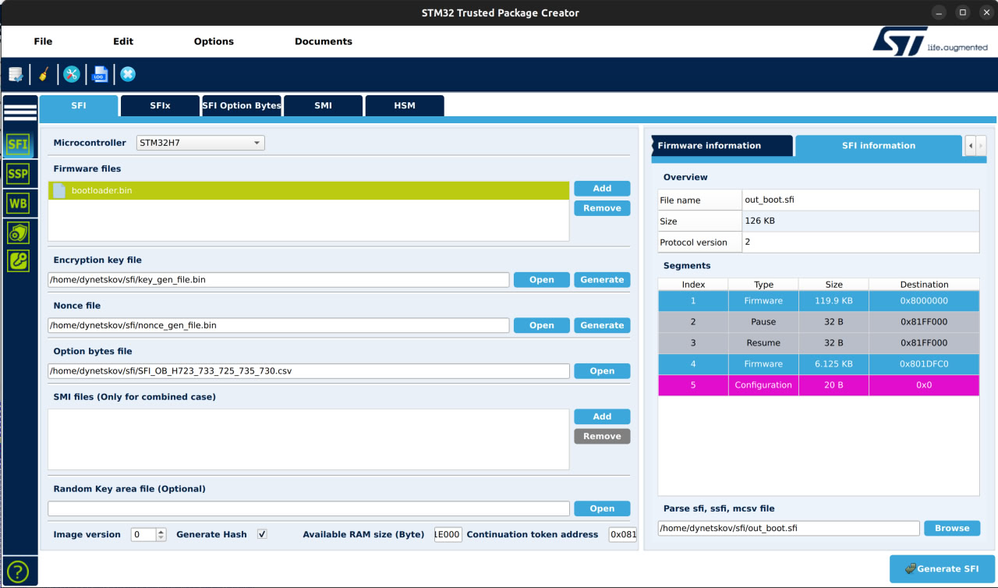

SFi creation:
License generation:

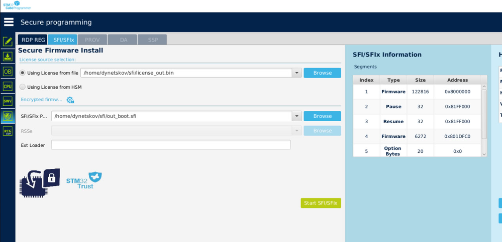

STM32CubeProgrammer SFI tab:
Full log:

Hello @dynetskov ,
The global license does not apply to this product.
You need to use the STM32 HSMV2  to generate the license.
Please check wiki and X-CUBE-SFI
Best regards
Jocelyn

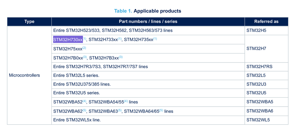

SMT32H730 is listed as supported product for SFI in AN4992
The full chip name is STM32H730IBT6Q
