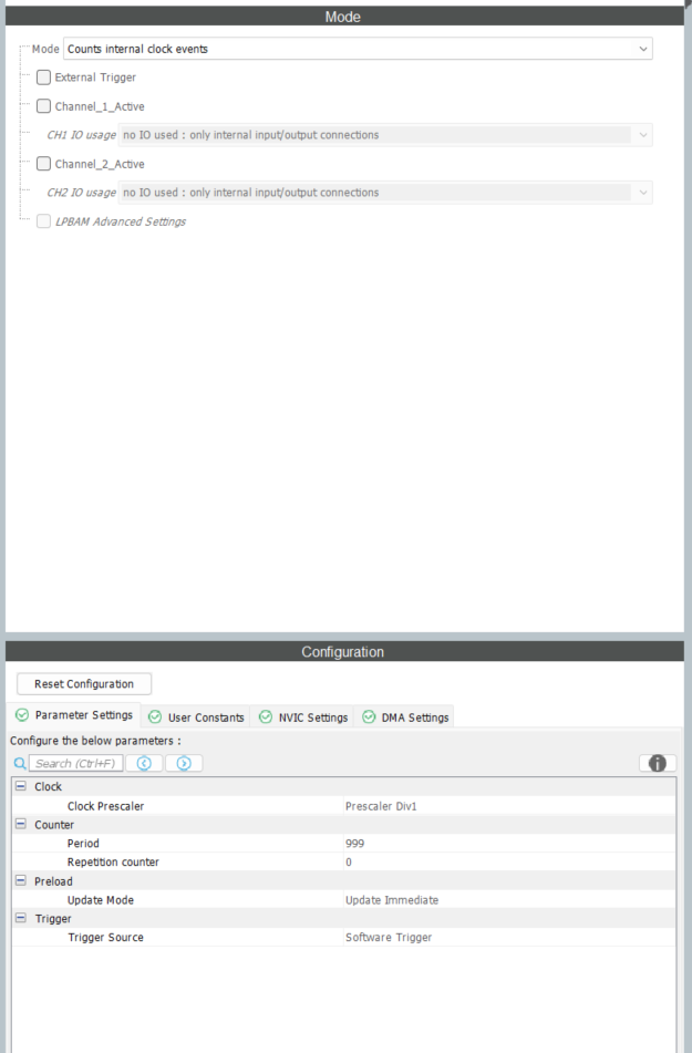

I am trying to us the LPTIM low power timer to trigger interrupts intermittently while the MCU is in STOP2 mode, but I am unable to do so. I am testing the interrupts by toggling a GPIO pin and checking the output on a scope.
Without STOP mode I see the interrupts and GPIO toggle as expected. Once I enter STOP2 mode I don't see any interrupts. Interestingly, if I debug the microcontroller via STLINK, I can see the GPIO toggle and a single interrupt trigger if I pause and then resume the debugger.
Is the LPTIM capable of doing this? I want to achieve repeated wake events to perform actions at specified times. The datasheet and reference manual say the LPTIM1 should be fully functional in this low power mode. If this is possible, what am I missing?
Using STMcube to configure the LPTIM and enable interrupts. I have tried configuring with LSI, MSI, and LSE as clock sources.
I am using HAL_LPTIM_Counter_Start_IT(&hlptim1) to start the interrupts and have used callbacks: LPTIM1_IRQHandler() and HAL_LPTIM_AutoReloadMatchCallback().
I am using the development kit B-U585I-IOT02A Discovery.

JKahn.1
I tried the same code with a similar configuration on a different development kit, the STM32L562E-DK Discovery. It works as expected there. Still not working on the STM32u585
JKahn.1
Managed to solve this thanks to https://community.st.com/s/question/0D53W00001zhW8ISAU/port-application-from-stm32l4-to-stm32u5-waking-from-stop2-by-lpuart-rtc-etc.
Needed to set the LPTIM1AMEN bit in the RCC_SRDAMR register to enable autonomous mode in stop mode.
Used the __HAL_RCC_LPTIM1_CLKAM_ENABLE(); macro to do this.
