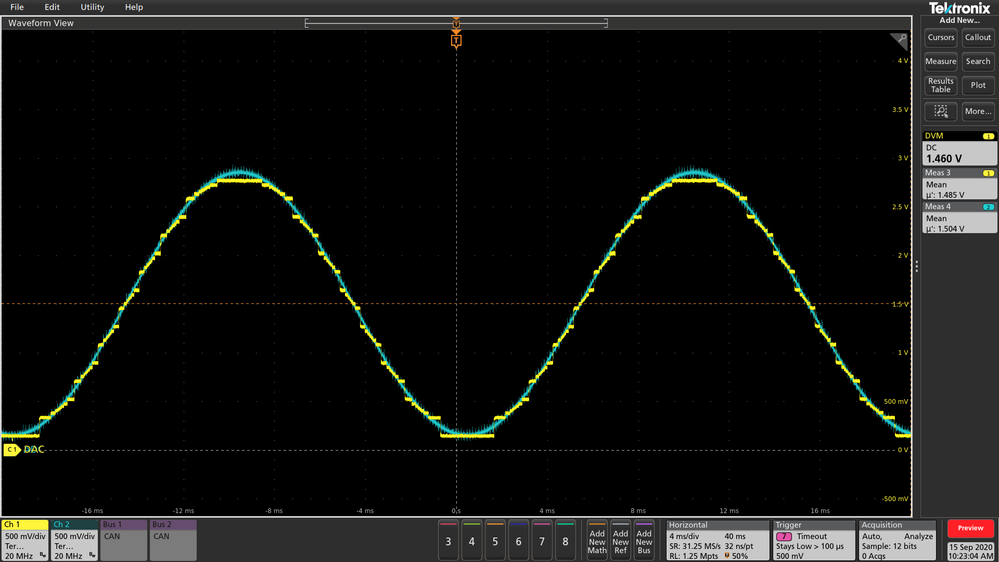

We encountered a big issue with the ADC's in a project.
The G4 device has 4 ADC's configured (ADC1, ADC2. ADC3, ADC5).
ADC1 and ADC2 are sampled simultanious and triggered by HRTIMER1A interrupt with 4 channels each.
ADC3 and ADC5 are in independent mode and are triggered at different times by HRTIMER1B interrupt with 1 channel each.
The problem we encountered now is that the ADC1 samplings are not consistent.
It seems like there are always "steps" on which the measured voltages stay or alternate.
First I assumed some problem with the ADC multiplexing, however after disabling all but ADC1 the issue is still there. The signals at the ports are all fine and stable without noise, the Vref is external but stable as well as Vcc. It somehow looks like the ADC got damaged. I tested the same code on a Nucleo board with the same result. We got like 20 PCB baords, all use the same code, but about a third of the boards are messed up. Another weird thing is, that the ADC measurements and "steps" are getting much worse with increasing temperature.
We need urgent help...

2020-09-15 1:29 AM
This is the waveform from DAC. you can clearly see the steps (about 64, however they aren't evenly distributed).
We checked another Nucleo board and one of our designs at another test bench and all show the same behavior.
This is really strange and too obvious to not to be detected before.
Yellow: DAC output at PA4 pin; Blue: signal from signal generator at PA0 pin
2020-09-15 1:50 AM
I dont see code, what you use but some mistake must exist. As first how amplitude have your generator ? Realy use full range of AD and how DC offset.
Second how type parameter use DEBUG_SECTION_DAC1_CH1 ( ?) . 3.how big is ADC clock/speed/sample time vs out impedance of generator eq dB down...
I check your scoped graph and here isnt 1kHz but 50Hz
2020-09-15 2:03 AM
1. Signal generator amplitude is set to 1.3V and DC offset is 1.5V.
2. The DEBUG_SECTION_DAC1_CH1 macro only points to the DAC data register. This is working fine, I tested it with several waveforms generated by MCU itself.
3. ADC clock speed is 170MHz and sampling time is 6.5 cycles, but I tried 247.5 cycles with no improvement. Impedance shouldn't be the issue, the problem exists even when appliying variable DC signal.
