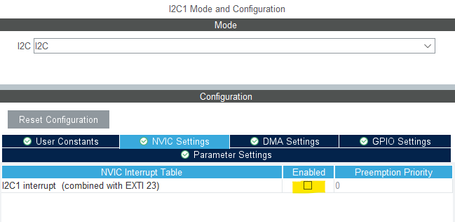

I2C HAL_I2C_SlaveRxCpltCallback is not called on slave after master transmit
HPate.12
I am trying to establish I2C communication between STM32C011 (Master) and STM32C031 Nucleo Board (Slave).
I transmit a message from the master, however, the slave side sees that the master wants to write to the slave (using HAL_I2C_AddrCallback) however, the HAL_I2C_SlaveRxCpltCallback is never called.
In another post, I see that the buffer length may be an issue, so I tried to transmit just one character but to no avail.
ChatGPT suggested I shouldn't re-arm the HAL_I2C_Slave_Receive_IT function as it can cause it to get stuck. I tried it with and without but same result.
I see "Master wants to write to slave" only once upon power up/reset of the slave MCU.

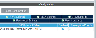

Karl Yamashita
Principal
Did you enable the NVIC?
If a reply has proven helpful, click on Accept as Solution so that it'll show at top of the post.

Yes, on the slave side (STM32C0 Nucleo Board) where I use interrupts, I have enabled the NVIC.
