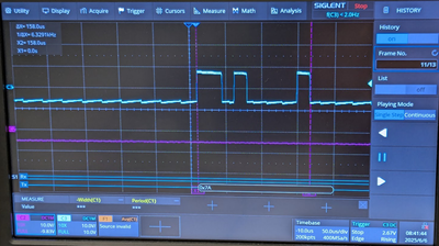

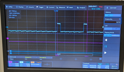

‎2025-06-06 9:52 AM - edited ‎2025-06-06 9:58 AM
> When this happens, the bootloader is activated and the baud rate is set to whatever width the first pulse is. Unless you send 0x7F, the baud rate will be set incorrectly and any future data will be correctly ignored.
That was my initial hunch, but I made sure to set all of the COM port settings equal between TeraTerm and Stm32CubeProgrammer. Indeed, comparing the RS232 traces of 0x7A (lowercase 'z' sent by Teraterm) and 0x7F (sent by STM32cubeprogrammer), the timing is basically identical.
In fact, if the message I send through teraterm is the DEL key (0xF7), the bootloader responds properly! So it seems unlikely to be related to timing/serial port settings.

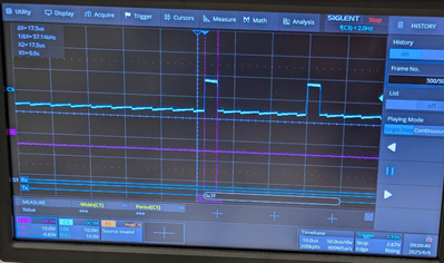

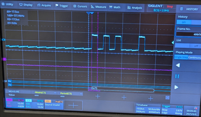

‎2025-06-06 10:38 AM
> The bootloader measures the first pulse on the channel to get the baud rate.
I think I may be misunderstanding you. If that were the case, then 0x75 ('u') should set the baud rate correctly, because its first pulse has the same width as 0x7F (17.5μs):
But, 'u' causes the same issue as any other byte.

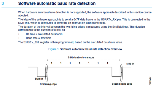

Did some more research and, yep, I just wasn't understanding properly.
For anyone looking at this with the same issue I had, it appears that my μC is using software-based auto baud rate. I didn't realize this, but this functionality always assumes that the first two pulses it receives represent the byte 0x7F, and configures the baud rate to match the time between those two rising edges (falling edges for RS232), setting the baud rate higher than it actually is. So, technically it's not measuring the width of the pulse, but rather the time delta between two pulses.
Above from AN4908
Then, (I'm assuming) it looks at that data frame using the calculated baud rate to see if it matches 0x7F. In my case, with the garbage data, it won't match, so it ignores it. But the baud rate has now automatically been set to the wrong value, and any other messages sent after this with my original baud rate will be ignored too. Only a reset will fix this.
So I guess my only real solution is to just always send 0x7F first if I can't guarantee whether I am connecting to bootloader or to application.
