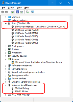

Does it appear in your Device Manager:
Have you tried different physical USB ports?
Are you using a Hub? If so, what happens if you go straight to the computer instead?
Are you sure the cable is good? Have you tried different USB cables?
#VCPDeviceManager

I finally did it. Somehow one of my USB ports can't recognize this board. but there is no problem with other devices.
