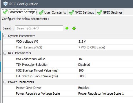

I'am use for a project the stm32f429. The interrupt handler must react so soon as possible.The stm32f429 interrupt responstime is 218ns.It's fast but not fast enough. I decided to make a new design with the stm32f767 running at 216 mhz. With the same configuration as the stm32f429 running at 180mhzThis configruation is generated with STM32CubeMX / KEIL vision MDK-ARM V5However the interrupt response time is much longer, it is 376ns !!
Well is the processing of instructions faster.What is the reason that the stm32f767 has a longer response time compared to the stm32f429 ??

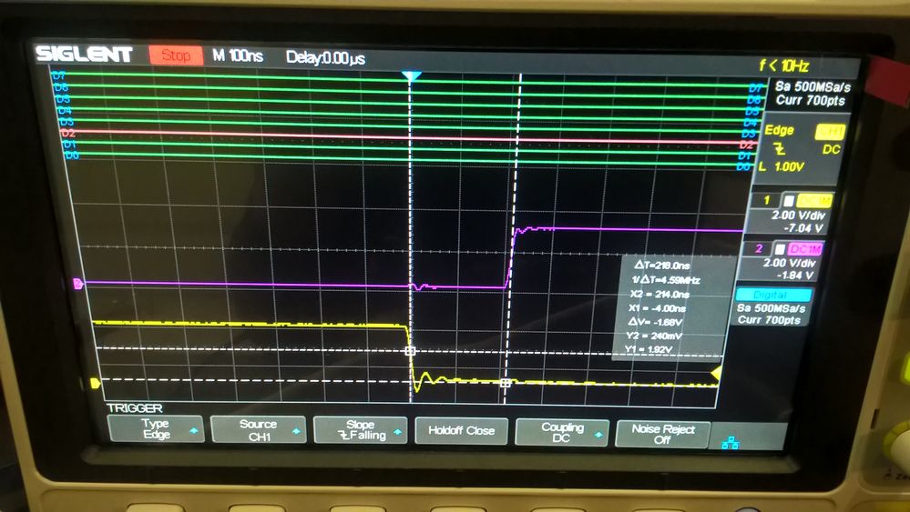

Hello Lawliet
The same configuration I mean the test, see scoop image.
Yellow channel is the chip select connected to the PC0 of the STMThe PCO is configured as ''Interrupt Mode Ecternal widh trigger Falling edge detection''Purple channel is the PG13 standard GPIO output (High speed) GPIOG-> = BSRR GPIO_PIN_13.;Very simlpe test.The question remains, What is the reason the stm32f767 That Has A higher response time Compared to the stm32f429 ??and has the stm32h7 same response time (next year)- Mark as New

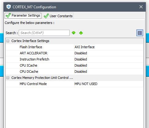

‎2016-12-14 9:20 AM
I thought The interrupt routine sevice from the STM is running in Flash Memory. is the ''accelerated by cache'' this what you see in the picture ??
I am a beginer ...
