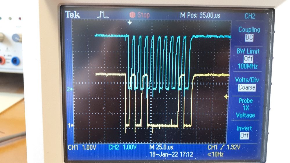

The oscilloscope for the failed transaction looks like this:
The clock signal seems possibly a little grubby, but other than that is there anything obviously causing WaitOnMasterAddressFlag to fail?
> Some of those SLC/SDA transitions seem pretty much simultaneous and neither SLC nor SDA really have time to get pulled up properly: is that a potential problem?
The scope trace is fine apart from the device not ACKing, which is a hardware problem or addressing issue. Your slave address looks correct, which suggests a hardware issue.

After a little confusion about the number, the A0,A1 and A2 pins on the mb85rc64 are physically wired to ground on the chip itself so I'm pretty sure about those (plus I've checked them on the oscilloscope) and we're pretty sure for the I2C wiring to the chip (although I'll check one more time). We actually have three of these boards all with the same symptoms so if there's an electrical problem it would pretty much have to be something systemic to the board itself so I'm really trying to eliminate as many of the unknowns as possible.
If the traffic from the CPU is good and the bus itself is clean enough then that eliminates pretty much everything except something electrical related to the mb85rc64 chip itself.
Yes, SDA changes at falling edge of SCL. That's OK, as tHD:DAT (i.e. data hold time that is measured from the falling edge of SCL) is 0ns, see I2C specification.
The basic requirement is, that during data transmission, SDA doesn't change while SCL is high (if they do, that means START or STOP).

I'd check all the memory pins first, supply voltage okay, ... ?
Then replace the memory with one from some trusted supplier.
BTW, if I'm not mistaken the I2C frequency seems pretty much lower than 100 kHz.
Not that I have seen a device that didn't run way below 100 kHz, but who knows...
