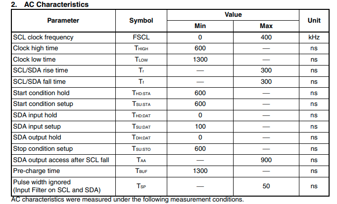

This is a bit of a shot-in-the dark, but since we're into an electrical problem and given that the chip connections seem fine I was looking through the data sheet:
0693W00000JMWaHQAX.pngand it seems like I'm exceeding some of the specs (my rise times Tr on SCL/SDA seem to be on the order of 2uS rather than the 0.3uS required by the spec, the start condition hold seems a bit border-line too).
Is it possible that my pullups are too high resistance and this is causing some sort of problem?
I've tried all sorts of frequencies, and even tried blasting through all possible I2C addresses one at a time, and its quite likely that this picture was taken during one of the lower-frequency runs. Nothing I've tried has made any difference so far.
My main worry was that I had somehow messed up the I2C initialisation, although realistically that was quite unlikely since the other two devices on the same bus work fine.
Try check if you don’t swap SDA SCL for this IC or all pins on memory package check...
Seems possible. Using a lower clock rate would fix it, if it's an issue. Note that the 0.3us is for 400 kHz, and you appear to be using 100 kHz. I guess the scope trace isn't perfect.
