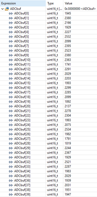

Just a quick follow-up on the design above, implementing the two-step (4x)10 sample acquisition scheme the code is running smoothly without any overruns. Thanks for the hint.

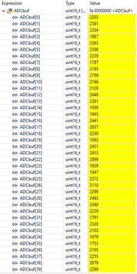

Even if code is ok, and data has been validated with bench tests comparing data with lab instrumentation I'm still confused by the data read during debugging in STM32CubeIDE. Let me expand:
1- I've ADCdata[40] buffer initialized to {0},
2- Breaking code execution on the very first execution of HAL_ADC_ConvHalfCpltCallback(), I get all the 40 samples, not only the first 20 ones!
3. Breaking code execution on the very first execution of HAL_ADC_ConvHalfCpltCallback(), I get all the 40 samples overwritten, not only the latter 20s!
And so on...
I was expecting only a partial update (Half: 0-19 and Cmplt 20-39) but this is not happening. Am I misinterpreting how the callbacks are called?
Thanks,
Luca
Do you freeze the timer while debugging?
DBGMCU->APB2FZ |= DBGMCU_APB2_FZ_DBG_TIM1_STOP;
In addition, you may invalidate the data you have just processed in the callback to prove that there is fresh data in the buffer at the next callback.
For further validation, you could apply some well known waveform (sine, sawe tooth), dump and analyze the dumped DMA buffer data.
hth
