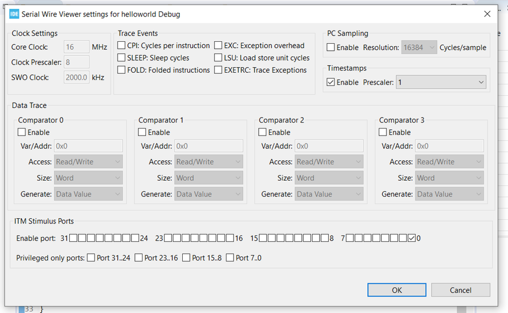

I cannot display Hello World on port 0. I have the STM32F429I DISC-1 board.

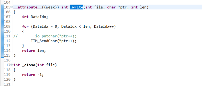

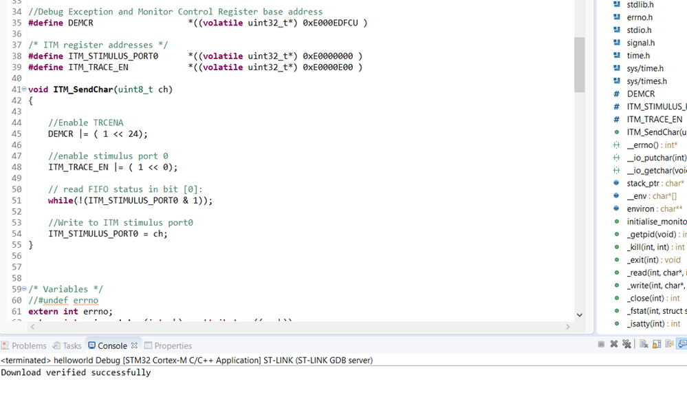

1. copy and paste the code into syscalls.c
0693W00000NsOhiQAF.png2. edit the _write function
0693W00000NsOhnQAF.png4. build the project

7. enable the SWV ITM Data Console
8. enable the port 0 in SWV

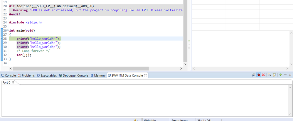

0693W00000NsOiWQAV.png9. the screen before press resume
0693W00000NsOibQAF.png10: Nothing come out... can you please help me?
SB9 is open by default

Use ITM_SendChar() by itself

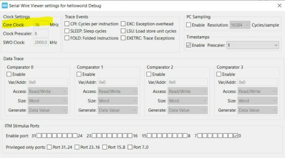

Are you really running the core at 16 MHz, and not 168 MHz or 180 MHz?

Check you Clock configuration (SYSCLK, HSE_VALUE)
0693W00000NsOkcQAF.jpgMake sure to connect the SWV pin for Trace functionality and follow this AN4989, which will help you on printf debugging.
