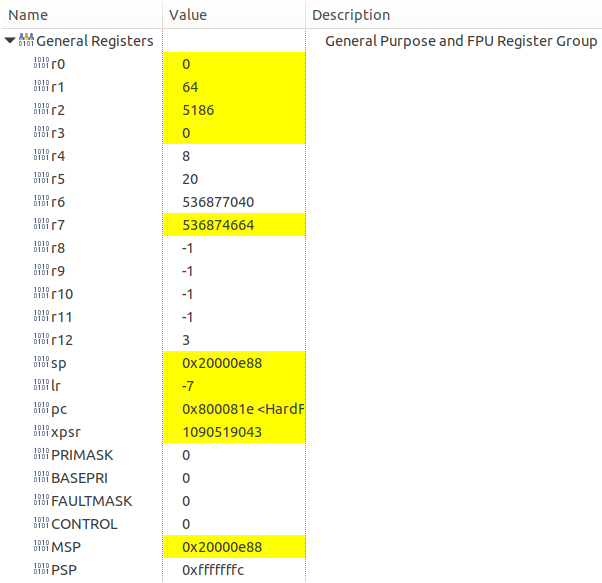

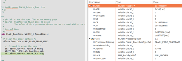

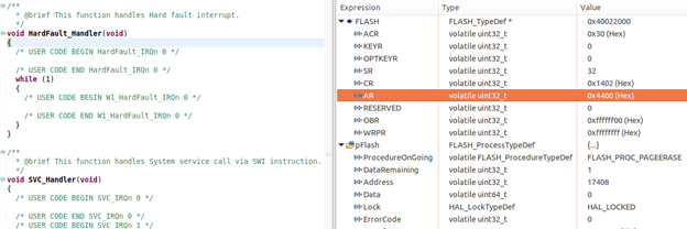

I am attaching some screenshots of the FLASH registers and the CPU register immediately before and after a sample hard fault.
Flash registers just before hard fault.
CPU registers just before hard fault.
FLASH registers just after hard fault.
CPU registers just after hard fault.

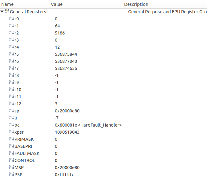

I apologize. My images show FLASH->AR as 0x4400, which is the offset into flash, not the page address. I just re-ran with FLASH->AR as 0x08004400 and got the same hard fault. There is no change before the fault except for FLASH->AR. After the hardfault, the FLASH registers are the same (except AR), but the processor registers are different. Here they are. I apologize for the confusion.
