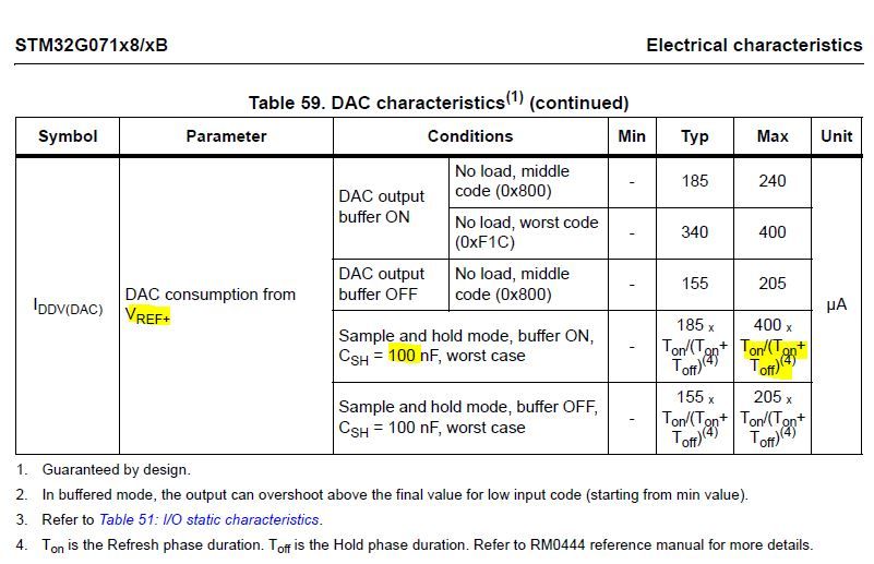

I use a LM4040 voltage reference IC to generate a 3.00V reference voltage for the STM32G0 VREF+ pin. The resistor is 750 ohms, so 4mA can be sourced to the VREF+ pin (the datasheet specifies a minimum of 500 uA).
I use the STM32G0 DAC (channel 1 only), which is connected to a TLV172IDBVR op amp. The op amp data sheet indicates that its input bias current is only 10 pA, so I have to suppose that the DAC can easily drive it.
When I set the DAC to a high value, say 3500 (out of 4095), the VREF+ pin reads very close to 3.00V, as expected. But when I set the DAC value to a lower value such as 0, the VREF+ pin drops to 2.875V. Since the VREF+ is no longer stable, all ADC computations that I do afterwards are off.
Does anyone know what could cause the VREF+ pin to drop its voltage?

Unfortunately, this is still a mystery because I experience VREF+ voltage drop even when pushing the LM4040 almost to its limit.
I decided to use a 27 ohms resistance, which should allow a current of 0.3 / 27 = 11 mA to flow through the VREF+ pin as well as the LM4040. My understanding is that the LM4040 will sink whatever current will not be used by the MCU.
Strangely, the VREF+ pin now reads 2.995 when the DAC output is set to 0, and 2.923 when the DAC is set to 4000. So it is the reverse situation I had when I was allowing less current to flow through VREF+.

can you provide a schematic? which device are you refer? Note that VDDA must be >= vref.
VREFBUF also must be disabled to provide external voltage reference.
Vref consumption depends also from load capacitance connected to output.(dynamic condition)
In some devices is possible the internal PU/PD resistors to be connected to pin , independently from DAC config.
Make sure that DAC output pin is set to analog mode before DAC is enabled.
Consumption also depend from DAC output buffer state. (Buffer acts like Op-Amp configured as voltage follower).
Try to disconnect external opamp to isolate the problem of increased consumption.
waclawek.jan
ADC loads VREF+ too.
Try a simplified program which does nothing but set the DAC once and then goes to loop.
Observe VREF+ using oscilloscope. I suspect the consumption from it is pulsed; try filtering.

I removed from my circuit a ferrite bead that I had inserted between 3.3V and the LM4040 resistor. I do not understand because this ferrite bead has a resistance of less than 0.5 ohms, but impedance of 600 ohms at 100 Mhz. So somehow, it is as if the ferrite bead was blocking current although the 3.3V isn't a signal with high frequency (unless it carries too much noise??).
Also, I removed the DAC buffering, it led to more precise ADC capture afterwards.

What capacitance do you have on the VREF+ against VSSA?
How do you know? Did you observe it using oscilloscope (and appropriate probing - we're talking millivolts and hundreds of MHz)?
As I've said, the VREF+ consumption is probably heavily pulsed.
