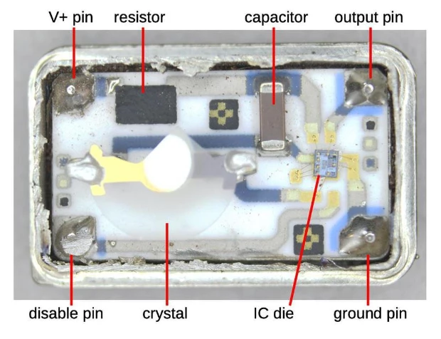

But here is a description of what's inside a Crystal Oscillator:
https://www.avrfreaks.net/s/topic/a5C3l000000UcE1EAK/t160729
As you can see, an oscillator is a complete active electronic circuit:
It contains a crystal plus  all the active circuitry necessary to make it oscillate and give a nice, clean digital clock signal as output.
The crystal itself is just a passive component:
it requires extra active electronic circuitry to make it oscillate.
In the case of a microcontroller, the oscillator  circuitry is usually inside the microcontroller chip (eg, the HSE within the STM32) - so you just need to provide the crystal externally.

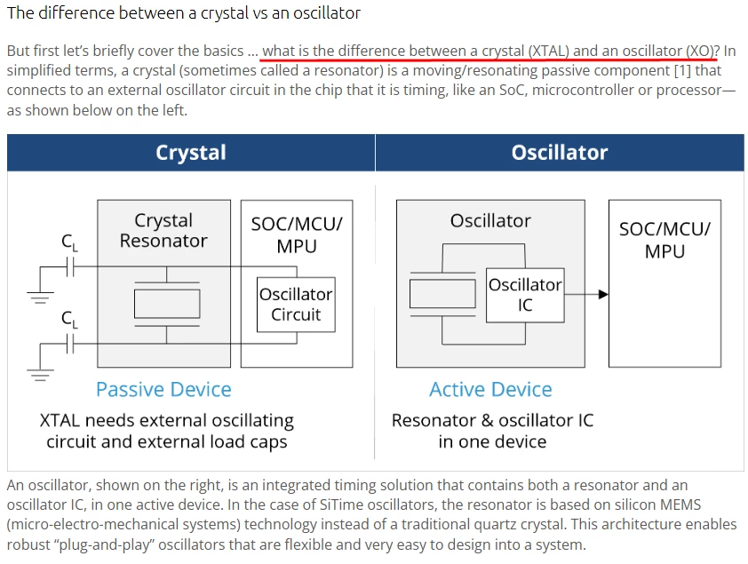

Update:
From an article from SiTime describing the difference between a crystal oscillator (XO) and just a crystal (XTAL):
https://www.sitime.com/company/newsroom/articles/do-you-know-when-use-crystal-or-oscillator-wrong-answer-can-cost-you

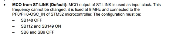

Apr 17, 2024 1:51 PM UTC
  1. According to the datasheet, HSE_OSC is specified to provide 8MHz,
Could you please indicate the page or a screenshot of the page? 8MHz could be generated by the STLink MCO and used in BYPASS mode from your target MCU.
As stated by @Andrew Neil the datasheet indicates that HSE could be in the range of 4-26MHz.
I found the "Input Freq HSE 8MHz" setting in the CubeIDE Clock Config. I don't have the development environment at hand currently, but I'll provide a screenshot of the source later.
So I can use STLink to program the microcontroller without providing an external oscillator externally?
However, the MCU requires an HSE of 8MHz for execution. Right?
According to the schematics there is no even the crystal PCB footprint on the board of the HSE. Could you please tell us which from which reference you did conclude this information. Could it be X3 (the crystal used for the ethernet PHY?
Yes, I mistook X4 for the HSE OSC. I found in the UM1974 User Manual that X3 is the HSE OSC. However, I'm still unclear about the meaning of 'not provided'.
Update:
