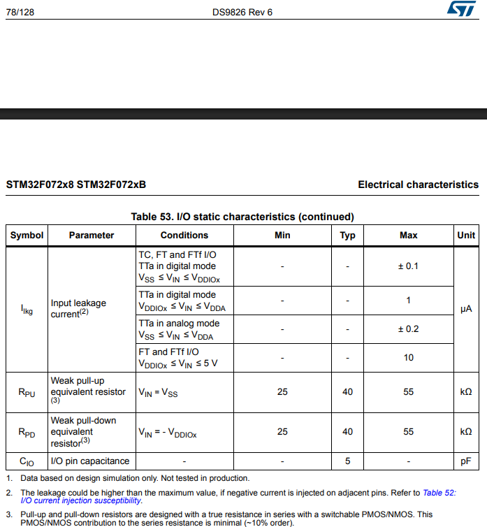

Andrew Neil
See the standard logic-level definitions for the pin - in the datasheet.
PS:
https://www.st.com/resource/en/datasheet/stm32f072rb.pdf#page=79
via: https://www.st.com/en/microcontrollers-microprocessors/stm32f072rb.html#documentation

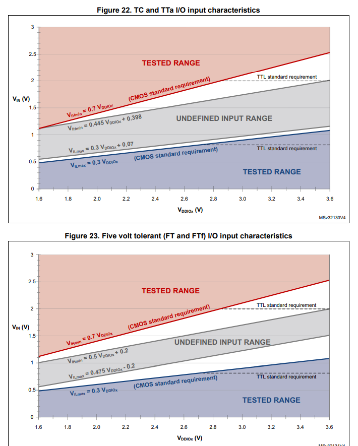

could please help find this value? I am confused by I/O voltage and rising edge voltage
"Rising edge" simply means a transition from a valid logic low level to a valid logic high level
                         __________________ Logic High
Logic Low ______________|
                        Rising Edge
  I think MCU detects rising edge determined by Logic high voltage level and ramp up time.
  I am hardware engineer So I need to know the Logic high voltage level, follow your info the 0.445VDDIOx+0.398V is right?
