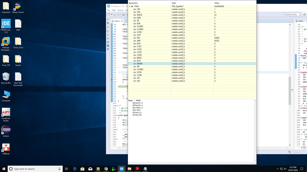

I have follwing changed my code and used another TIM4 as master and same TIM3 as slave
APB1 Clock freqruency is=108MHz
TIM4->PSC=108
TIM3->PSC=1080
TIM4 & TIM3 both are 16 bit timer so ,ARR value is=65535 for both
so accoring to calculation i should get timer 3 will increment at ~71 sec by 1 but i am getting increment at ~143 sec
so what i am going wrong?

Check your clock configuration, because APB1 timer clock is at most 90 MHz.

If APB divider is not 1, TIM is usually not clocked at APB clock but at twice that. Read the RCC chapter.

I have configured timer 6 as below, my timer clock frequency (APB1) is 108 MHz
RCC->APB1ENR |= (1<<4);   // timer 6
TIM6->PSC = 108;
TIM6->EGR = TIM_EGR_UG;
TIM6->ARR = 10000;
TIM6->CR1 = TIM_CR1_CEN;
count = TIM6->CNT ;
I am not getting 10 millisecond of timer yet

The counters start from zero. Try PSC=107 and ARR=9999. Any closer?

Are you going to tell how long is it then, or do we have to guess?
dbgarasiya
Senior
March 4, 2020
it is appoximately 333 us of timer with this configuration .

turboscrew
Senior III
March 4, 2020
In that case, check your clock tree.
dbgarasiya
Senior
March 4, 2020
I have used timer 6 which is clocked by timer clock register is RCC_APB1ENR
like this
RCC->APB1ENR |= (1<<4);  // timer 6 which is 108 MHz
i am attaching you my clock configuration sceenshot for this, so you will get better ide about this
